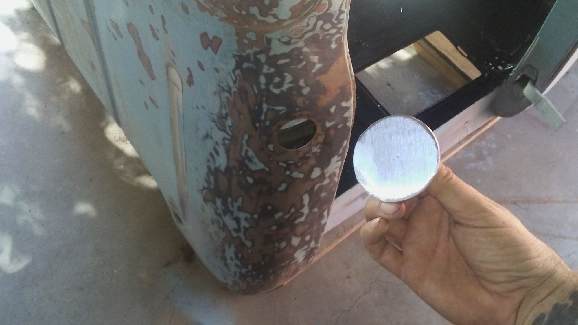

The last one I did I just used a spare cab corner that I had. Cut out the piece that covered the filler hole and welded it in...
$30 from Midfifty...http://www.midfifty.com/item.php?INV...r-53-56-driver
