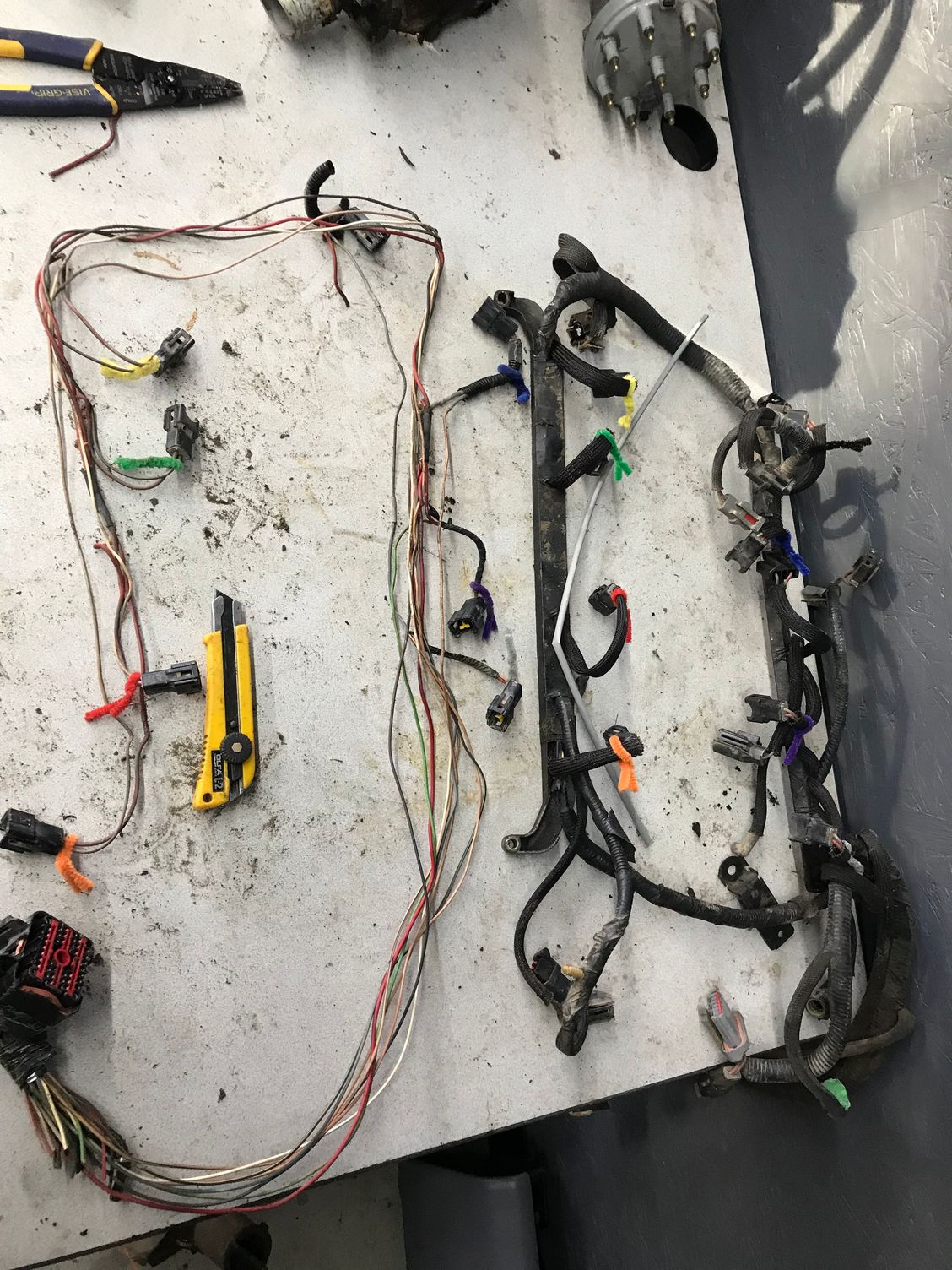

Old 10-15-2017, 10:45 PM
Midnite1987's Avatar
Midnite1987 Midnite1987 is online now
Join Date: Jan 2011
Location: Edmonton AB, Canada
Posts: 2,665
Midnite1987 is a splendid one to beholdMidnite1987 is a splendid one to beholdMidnite1987 is a splendid one to beholdMidnite1987 is a splendid one to beholdMidnite1987 is a splendid one to beholdMidnite1987 is a splendid one to beholdMidnite1987 is a splendid one to behold
Started digging into the donor harness and looks like I have some repairs to make. I might just look for a overlay harness I can buy to make this simpler since Iím going from a 4.9 to a 5.0 and maf all at the same time
