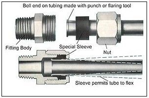

When is the last time you replaced the vibralok sleeves on the fuel lines at the filter bowl?
replaced with the gasket kit as per my initial post
