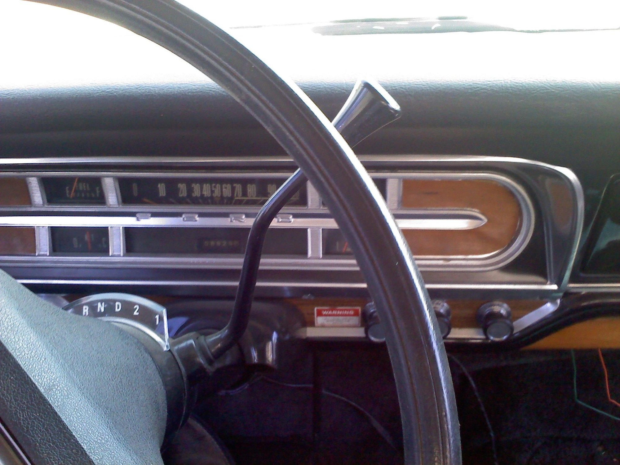

Here is the wheel I bought and plan to use
The key wasn't put on the side of the columns in the trucks until 1980. --no key on the '78/'79 tilt wheel columns.
'78/'79 truck columns, whether tilt wheel or not, do not have the NSS on top of the column tube like the trucks had through '77. '78/'79 column/wiring is designed for an NSS on the side of the (automatic) transmission. If you have an automatic, you will either need to mount an NSS to the transmission or, jump out the NSS. Just know that the engine will crank in gear if it's jumped out.
If you have a standard transmission, the NSS won't matter.

Thanks Steve, it is a 3 speed on the floor. In your opinion will my wheel bolt on to that column?
That style steering wheel was used through 1970 but, as far as I know, it would also slide onto the splines of a '78/'79 tilt/non-tilt wheel column steering shaft. The only thing that may interfere is the mushroom head at the upper end (tip) of the steering shaft. If so, the mushroom head can be cut off.
