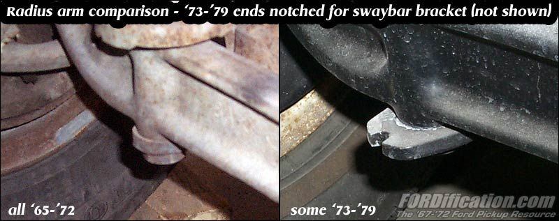

The 'C-brackets' have only one component number (5C499 in illustration below), meaning there isn't a left and right hand endlink bracket. It is simply flipped over, depending on what side it's being installed on for the locating pin to engage into the notch at the forward end of the radius arms --notch is located on the lower end of the right side radius arm and at the top on the left radius arm. --the radius arms are also not side specific. They will work on either side by simply flipping them over too. Only the lower shock mounting brackets attached to the radius arms are side specific, left side and right side.
'65-'73 radius arms are cast steel and don't have any material protruding off the forward ends for the pin on the C-brackets to engage into.

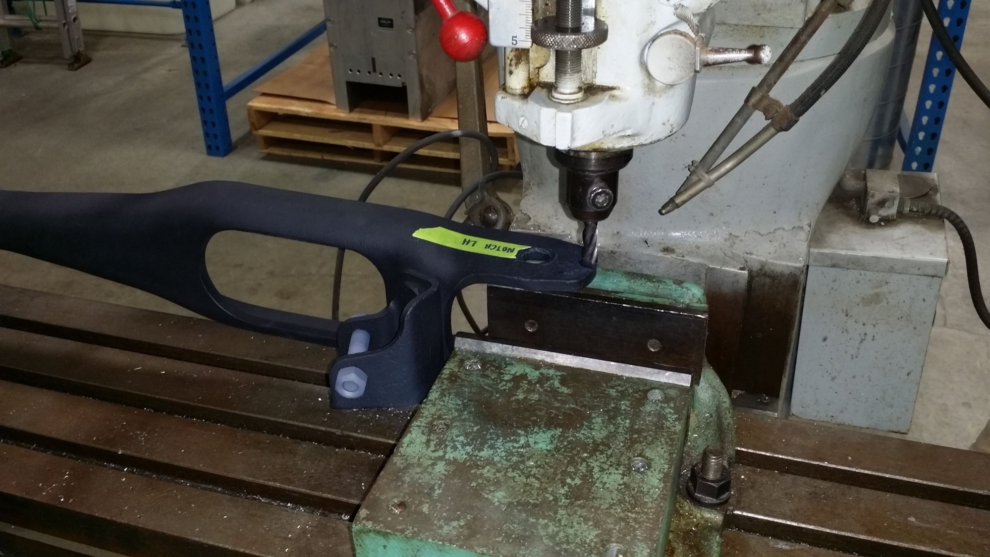

'74 model trucks went to the stamped steel radius arms. However, the forward ends aren't notched for accepting the locating pins on the C-brackets but, the '74 stamped steel radius arms can be notched, as I did to these '74 model radius arms.
'75-'79 F100-F350s will have the notches in the forward ends of the radius arms whether the truck came with a factory swaybar or not.

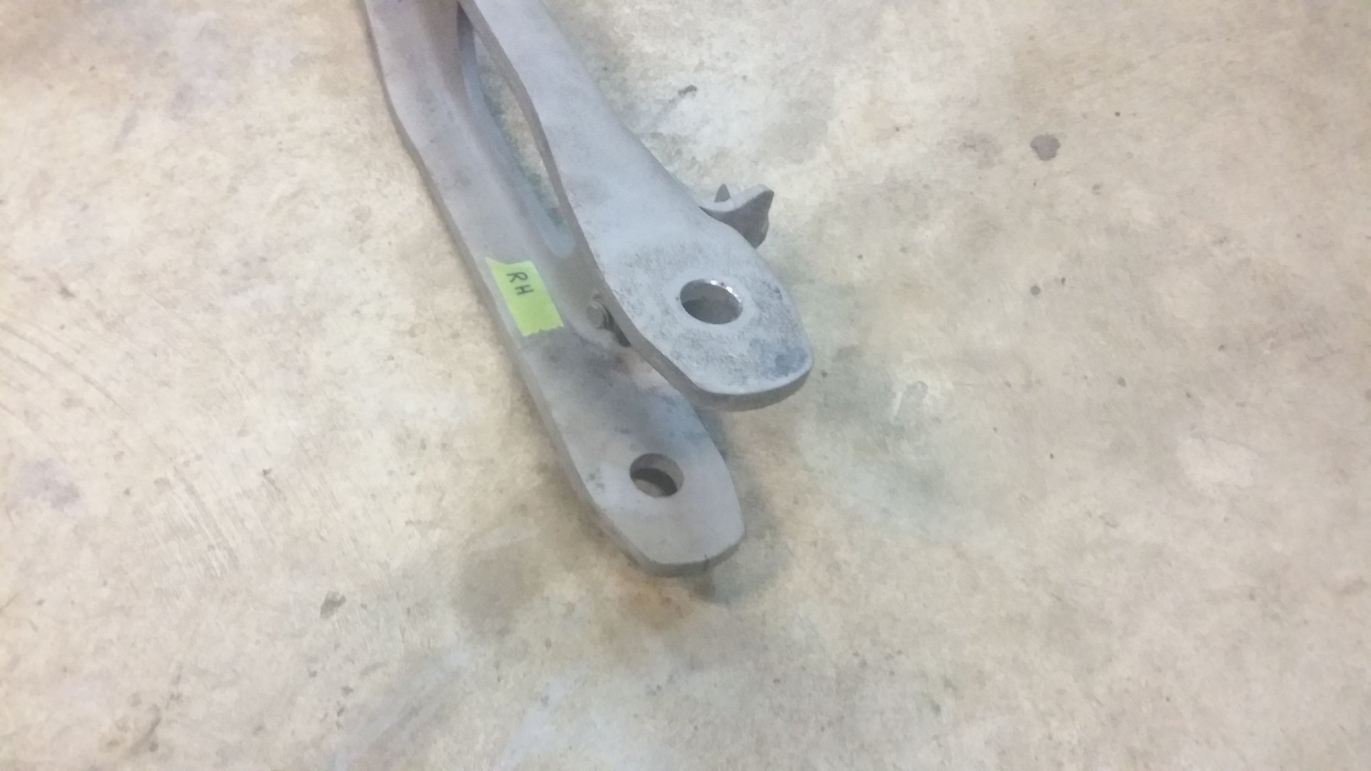

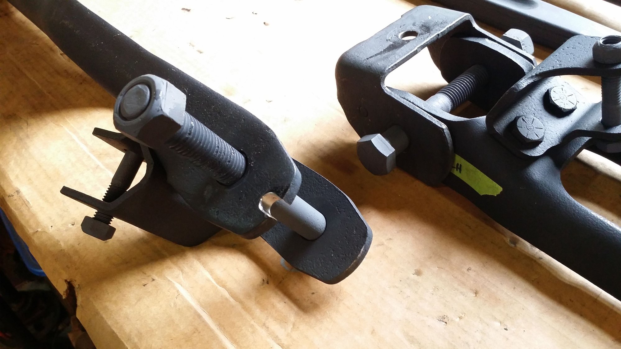

Pretty much what ultra wrote, but one thing, not all arms have the notch, he showed you how to fix that, I had to replace an arm as the original bent a bit and had no notches. I just used a HF grinder and disc it radiused it the other thing is that the actual bracket maybe the part same part number I'll have to try see if I have some more pictures on there cuz I did this a few months ago and I don't know if I've deleted those already but my brackets one of them had an R and the other had an L so they were side specific probably so that you wouldn't mess up but they were marked that way, as the ears point in a specific direction. Or knowing Ford maybe mine were some oddball ones that got stamped. I just went thru this on the front on my 2wdF-250 and the rear on my son's 4x4 F100 last week. Pictured here.
For comparison you can see how different the 4x4 version is, it also had to be modified as it's on the son 75 F100 that never came with swaybar. These are adapted from the same 79 Bronco donors as the rear set up.
