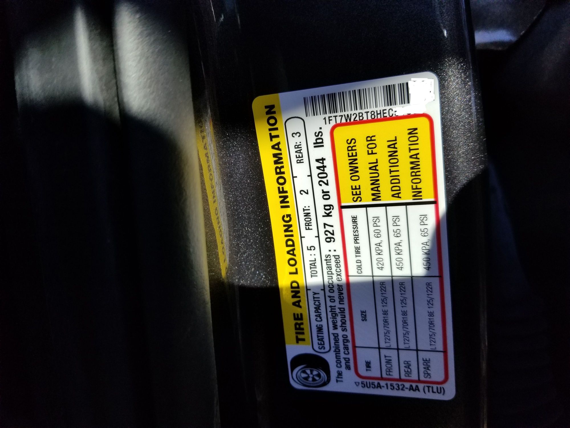

Tire loading
On my '17 F250 the tire rating (yellow & white sticker on the door) says I'm limited to a max. truck load of 2,044 lbs. When you factor in a couple of people and the weight of the 5th wheel hitch it doesn't leave much left for pin weight. Everyone talks about GVWR, GCWR, Max tow rating but the tires are my limiting factor. Why isn't this talked about more?

I think that yellow sticker shows payload capacity which is the difference between 10k lbs and your curb weight on an f250.

As you can see this label clearly says I cannot exceed 2,044 lbs of weight in the truck. My GVWR is 10,000lbs. And it shows a max payload of 3,450lbs in the tech specs. So it looks to me that the tire rating is limiting what I can put in the truck.
2,044 minus 400# for people/stuff minus ~220# for hitch = max ~1424# for trailer pin.
Am I looking at this wrong? If so please explain.

It's not the tires. Look on the sidewall of your tires and it will give you the max load for the tire at the max pressure. I have the 20" Michelins and mine are rated at 3750#. Multiply x4 and that exceeds the vehicle GVWR of 10k.
