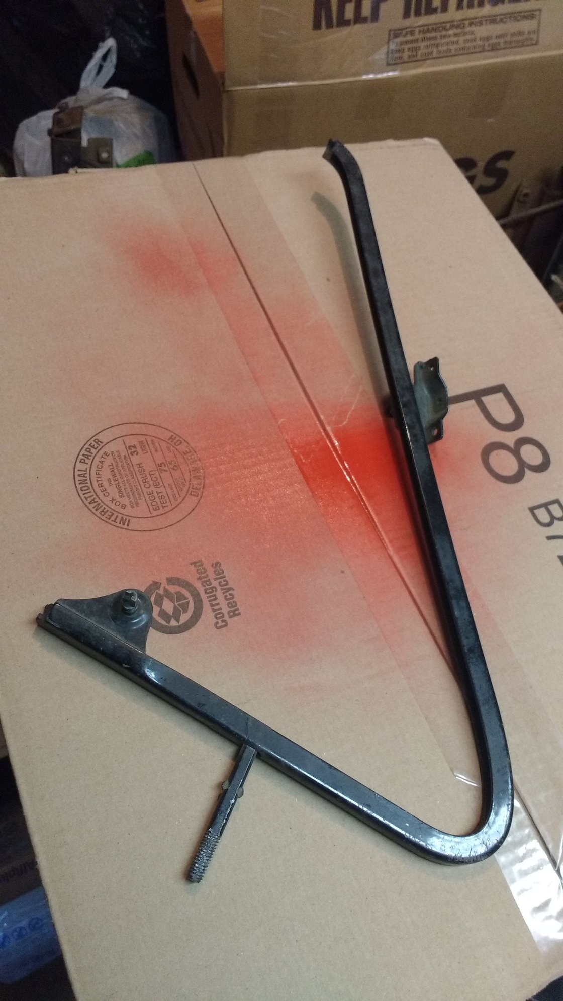

Can anyone ID this vent frame? It has no numbers on it.

It's not 1967 F100/750, because '67's don't have that pivot bracket.
1968/72 F100/750 used a different pivot bracket than 1973/79 F100/880, but this vent frame could be from a car. In fact, it may not even be from a FoMoCo vehicle.
Trying to ID vent frames from FoMoCo parts catalog pics, can be a study in futility.

None of the pics I looked at had that mellow curve at the top. I tried Bullnose, baby Ranger/Bronco II, and 75/ Econolines.

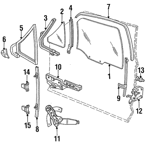

Here's a Dentside one.

Here's a Bullnose.

Here's an Econoline one.

Here is one for the Slicks.

Best I can come up with for baby Ranger and Bronco IIs. Part numbers E3TZ1021608A and E3TZ121609A.

So the best I can figure is that it's a 68/72 Bumpside one. But I can't find any pics of one.
L/S.....C8TZ8121609A.
R/S.....C8TZ8121608A.
