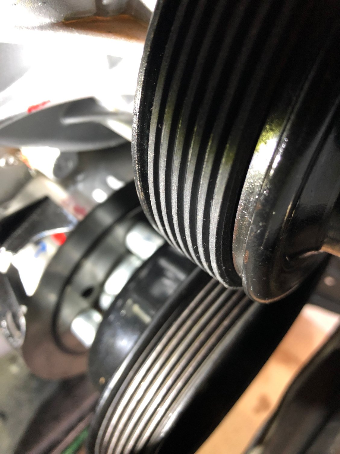

Some pic of problem
#1 marked too have you guys tell me wear I’m screwing this up in these 2 pic both taken with out moving the crank

Dark red is TDC, lite red is 10’, white is 20’ Am I at TDC Pic taken at the same time engine as previous post It won’t run unless I give 20’ so is what I have correct
so I’m about 8’ btdc and the rotor is just past #1? Is that correct? I’ll check the piston after lunch

I'm going to look at 2 5.0s tomorrow & get back to you, but that looks correct for just a bit before #1 if the timing mark goes with the rotor shot.
