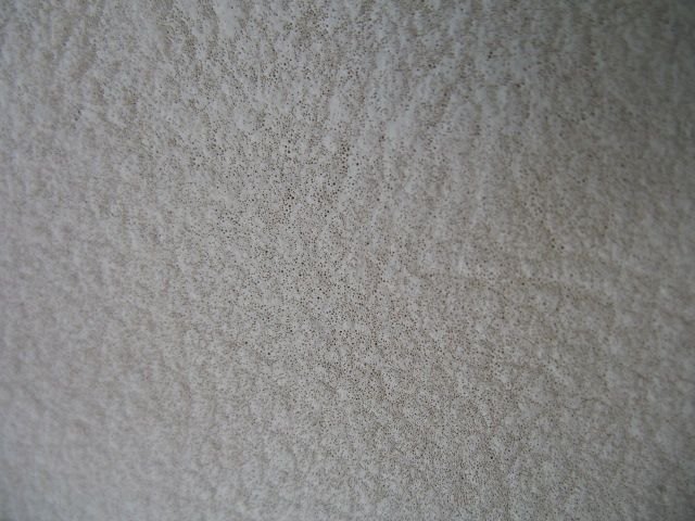

I purchased a pair of deluxe padded visors from Dennis Carpenter and, as you might be aware they're not inexpensive. They looked dingy when I got them but I knew I was going to dye them anyway, so I figured it would cover. Unfortunately, the defect that made them look that way, is severe porosity in the surface of the vinyl so that they still look terrible even after color coating. Has anyone had this problem or, more importantly found a padded visor of good quality?? It's not the fault of the color coat which is SEM Classic Coat, as I used the same material on the armrests and they look perfect and I have used the SEM products before, finding them to be of high quality. Photo shows the severe porosity in the material.

That is ugly. I think DC owes you a new pair.

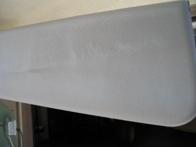

Kind of figured these would be the only game in town. I mostly (90%) solved the problem by laying the visors flat, spraying the color coat on heavy (until it puddled) and used a small piece of neoprene rubber as a squeegee to force and flow the coating into the porous areas. It was a little tricky to get it to look right and working quickly before it dried and it took a lot...a whole can of spray...to lay it on thick enough to look decent. Just in case anyone has to deal with these...
