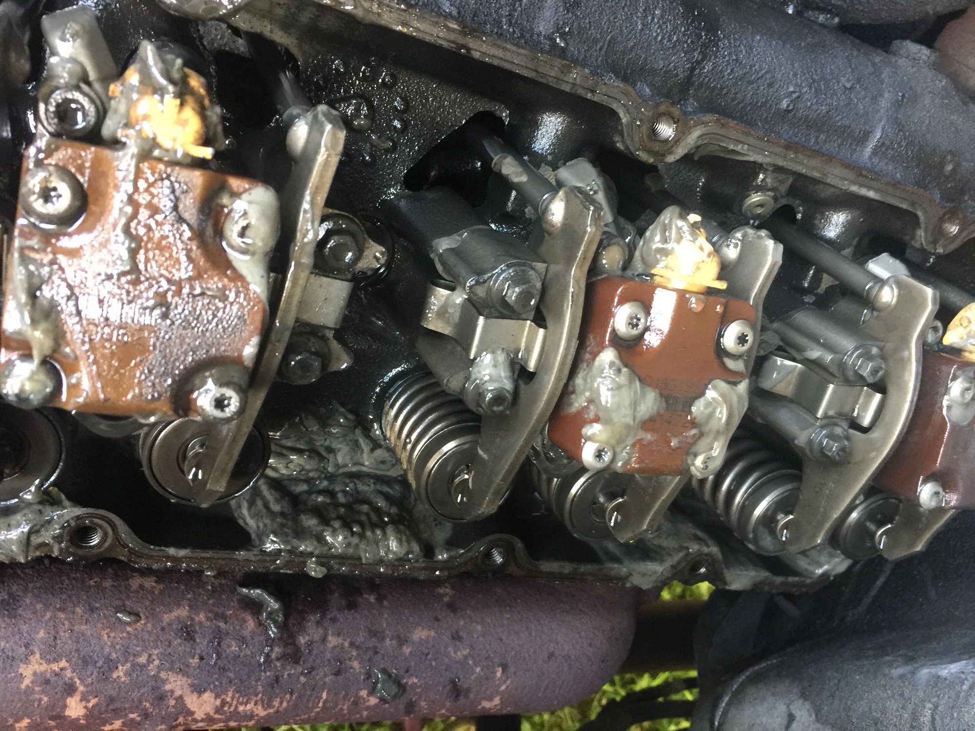

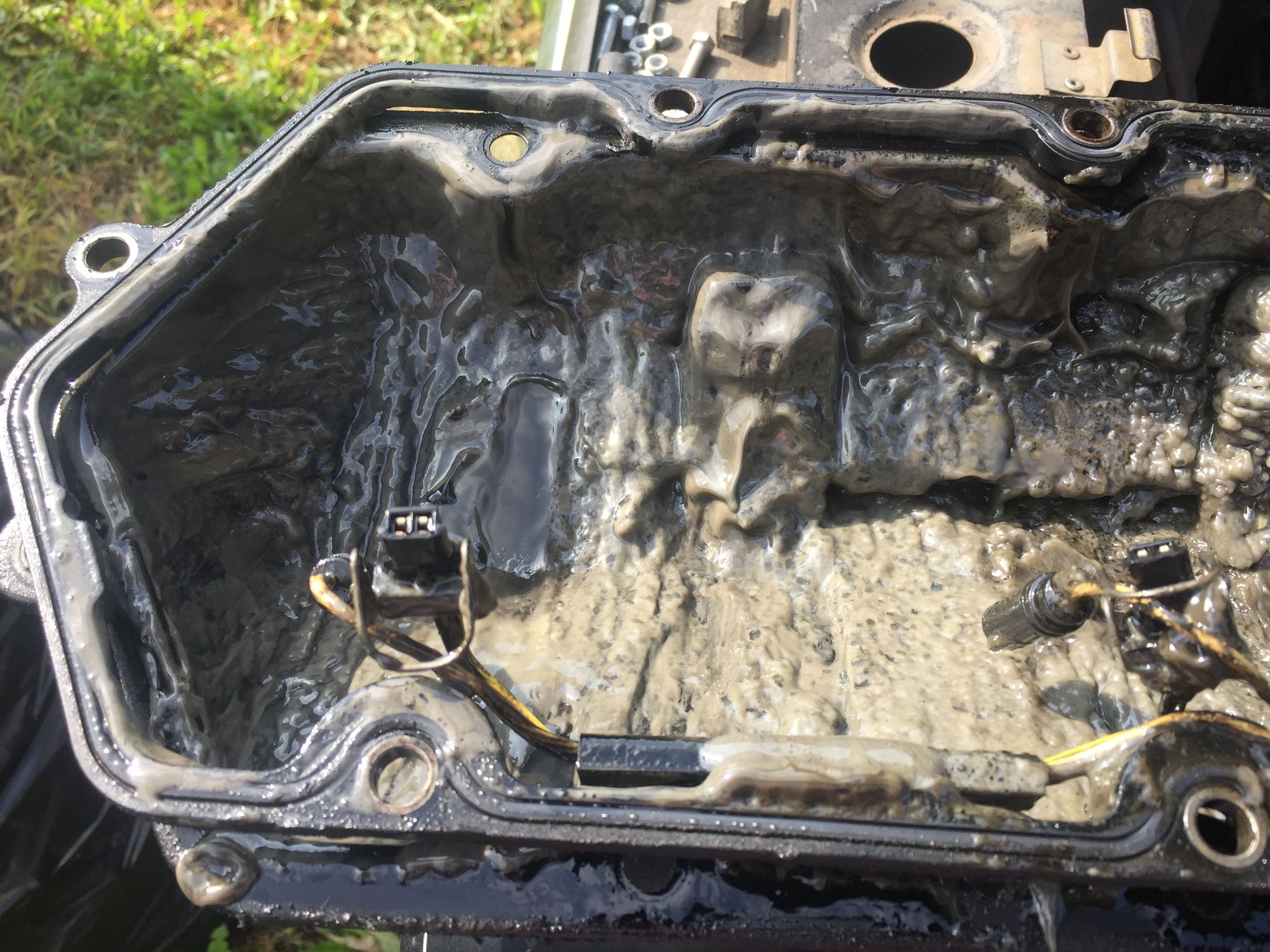

Ok so today pulled the valve cover off and this is what it looked like on the inside also drained the oil and there was a good amount of coolant in the oil. Also the fuel filter looked normal to me wasn't black or discolored. Looks to be oil in the coolant also not drained It yet. Could a cracked cup cause this much damage under the valve cover?

I'm thinking oil cooler but one with better knowledge on this should be along soon.
