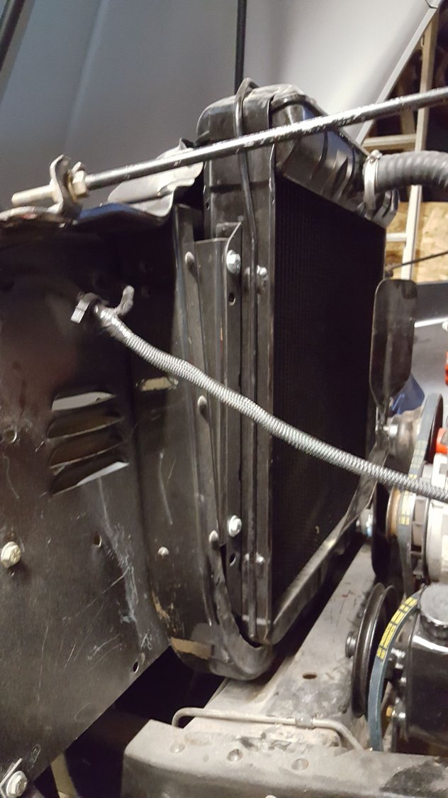

Hey guys does the radiator mount to horse shoe..does it slip in the saddle if so,how high up is it...

Just from what I can see, the radiator is sitting just about right relative to the saddle, but the saddle is mounted in the 6 cylinder position on the frame. For the v8, it was moved back to the other set of holes in the frame crossmember.

So I got back working on the truck. Went to move the radiator and realized that there is only one hole on the upper crossmember. The radiator horse shoe has two stud. Should I drill anther hole to mount it or do I have the wrong horseshoe.
Thanks
Dan

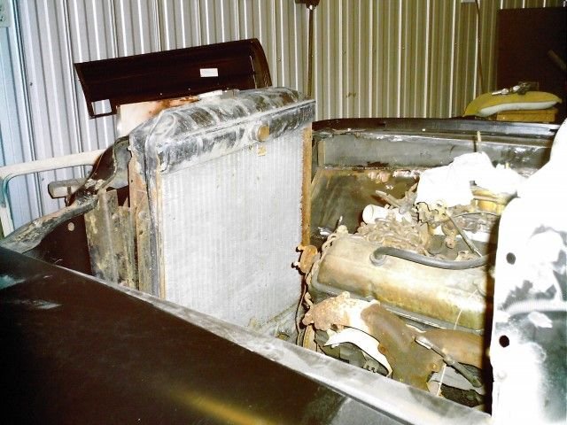

The horse is mounted in the correct position 682bear is talking about an F1 , it appears you have a 55 or 56 but that radiator looks as though it sits high. I'm wondering if the rad is the wrong one..I'll look for a picture of mine in a 56
Old Oct 24, 2017 | 07:52 PM
56panelford's Avatar
56panelford
Posts: 283,495
Likes: 8,197
From: northwestern Ontario

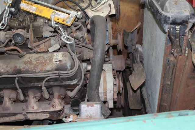

here is what mine looks like...looks the same to me
Looking at it again I think it is likely the right rad but looks higher without the radiator valance on the horseshoe ..
