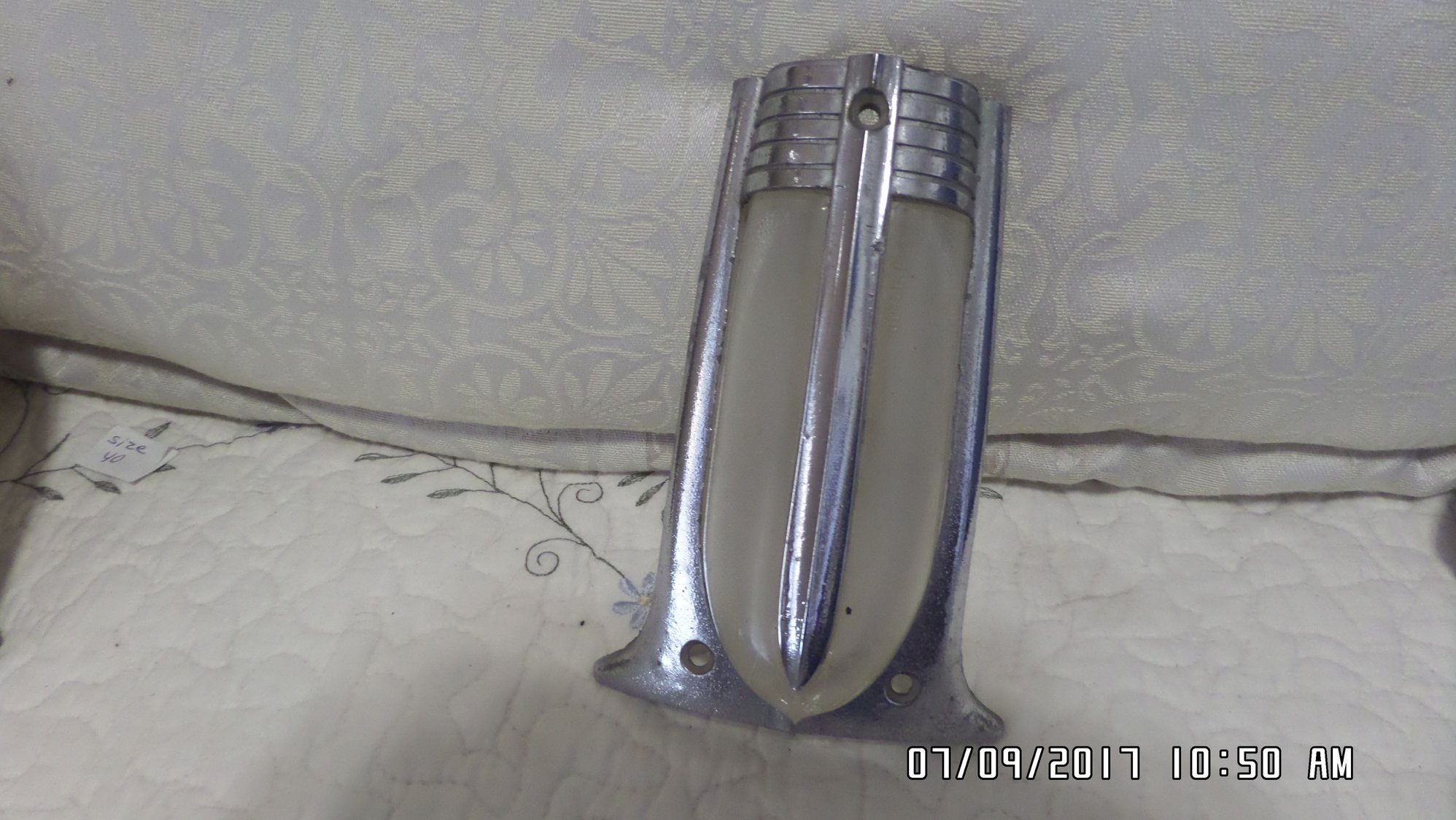

what is this ?
i found this in a box at a yard sale.no one knew what it was.i told them that a collect odd parts for my garage.they said here is a donation for your garage.does anyone know what it is and what kind of car it came off of ?

Looks more like from a boat than car.

I don't know what make model but I'd guess by the shape it's an interior lamp from the "B" pillar from a 4 door sedan. I'd think the unit is upside down in the pic

Wasn't four beads a pontiac thing?

Is that opaque plastic? like a lens? if so then I agree, must be some kind of interior light but I don't know from what

1930's or 1940's?

I'd say post ww2. Looks like about 1950

Does it say Guide or anything on the back side or lens?

Looks similar to the 1949 or 1950 Ford Fordor (4 door) B pillar lamp bezel.
Flip the puppy over to see if there's any numbers marked on it.
Pontiac hood and decklid 'strato-streaks' were the brainchild of Pontiac division prez Semon E. Knudsen in the early 1930's.
His son, Semon E. "Bunkie" Knudsen removed them in 1958!

ross,yes it does say GUIDE F-4

If it says Guide then it is General Motors.

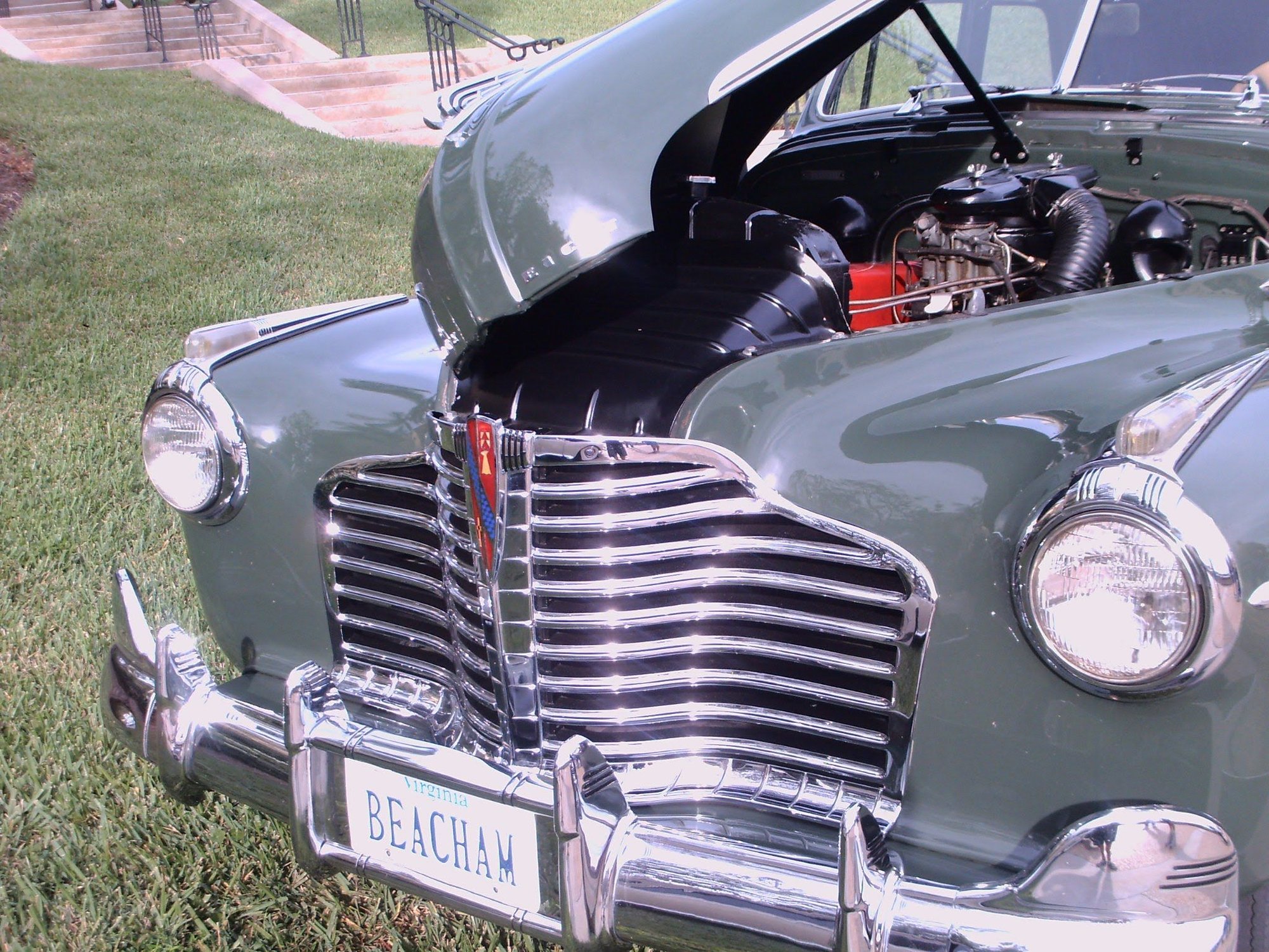

1941 Buick front parking light

Gah! He beat me to it. I had it narrowed down to a Buick product, but hadn't fingered the exact application yet. Good show!

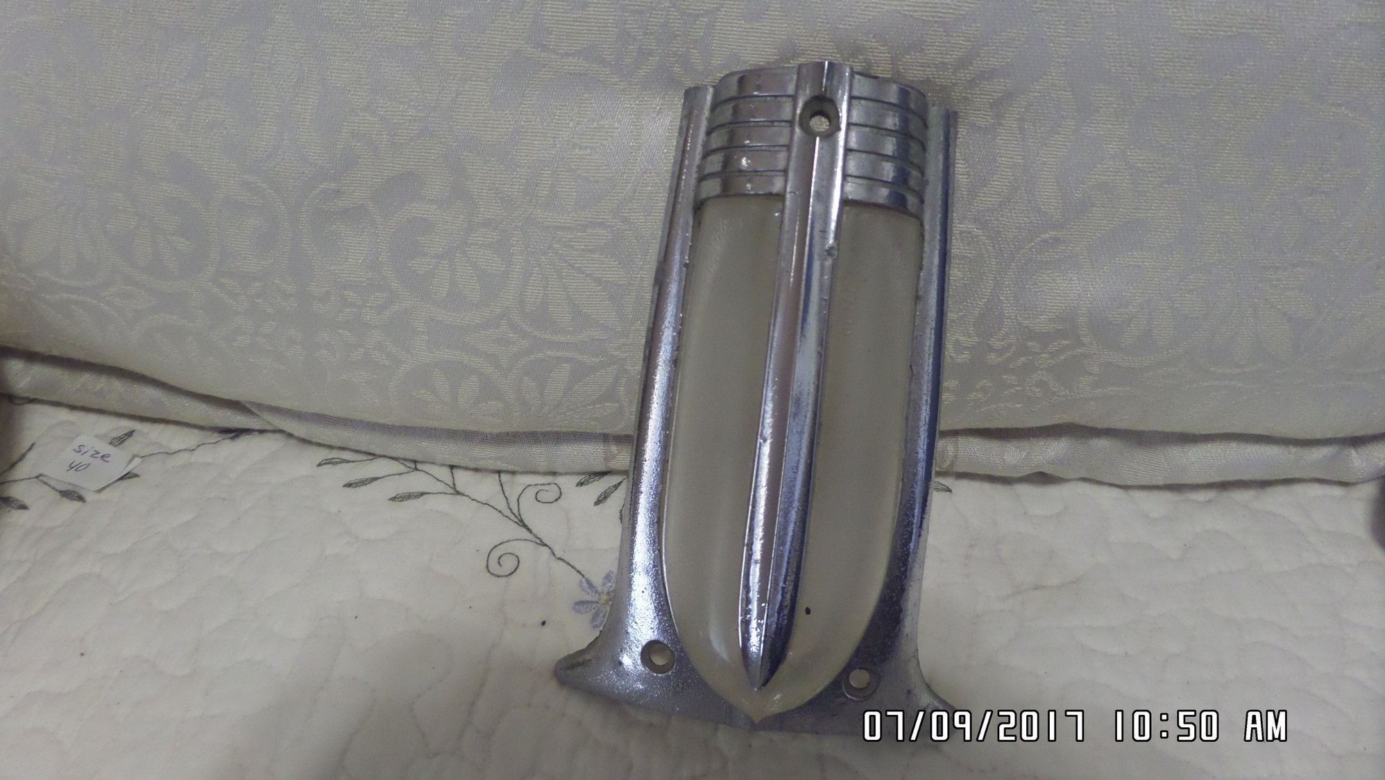

The picture Bob posted is a little deceiving since it makes it look flat, not the domed shaped it is.
