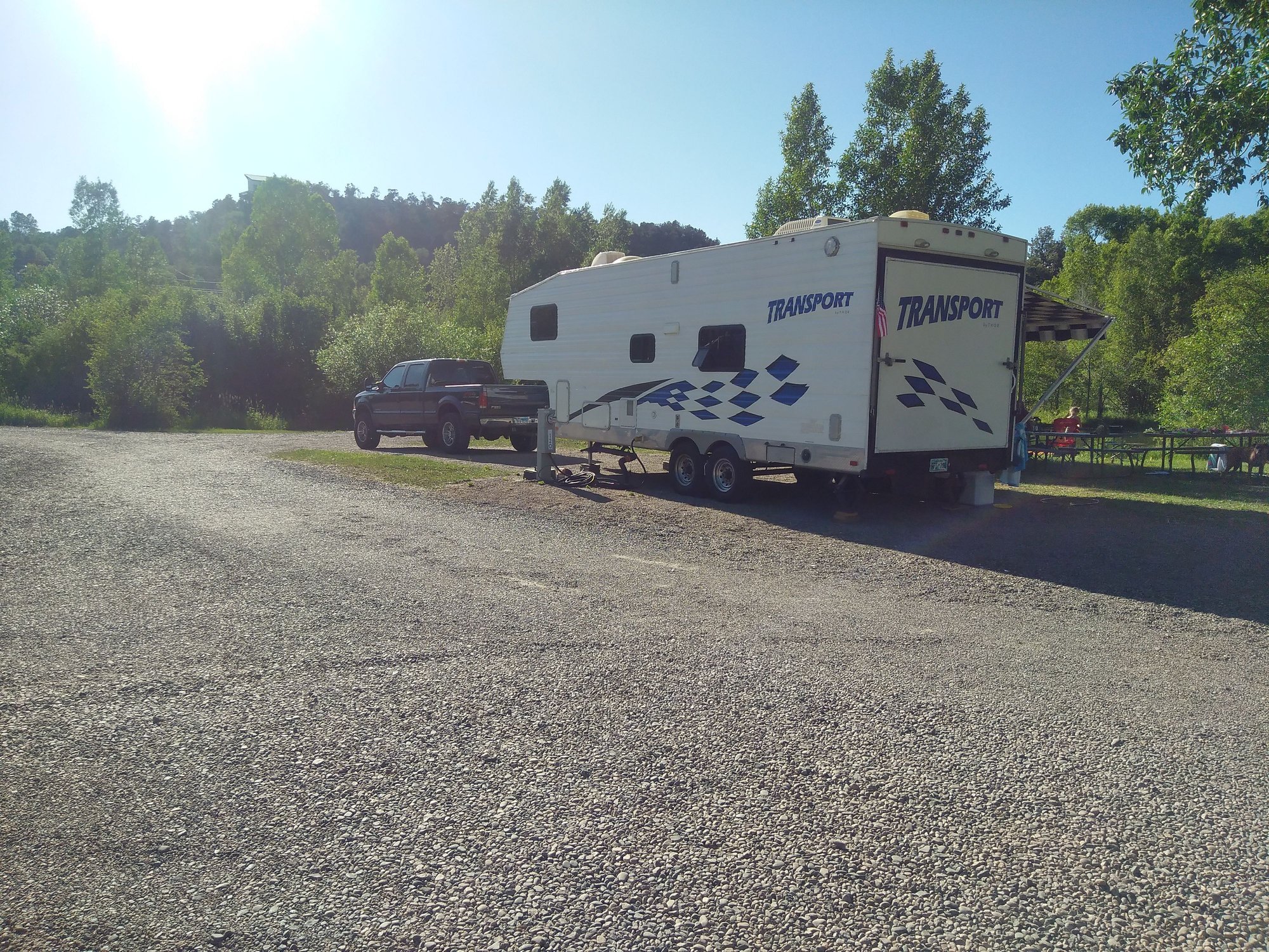

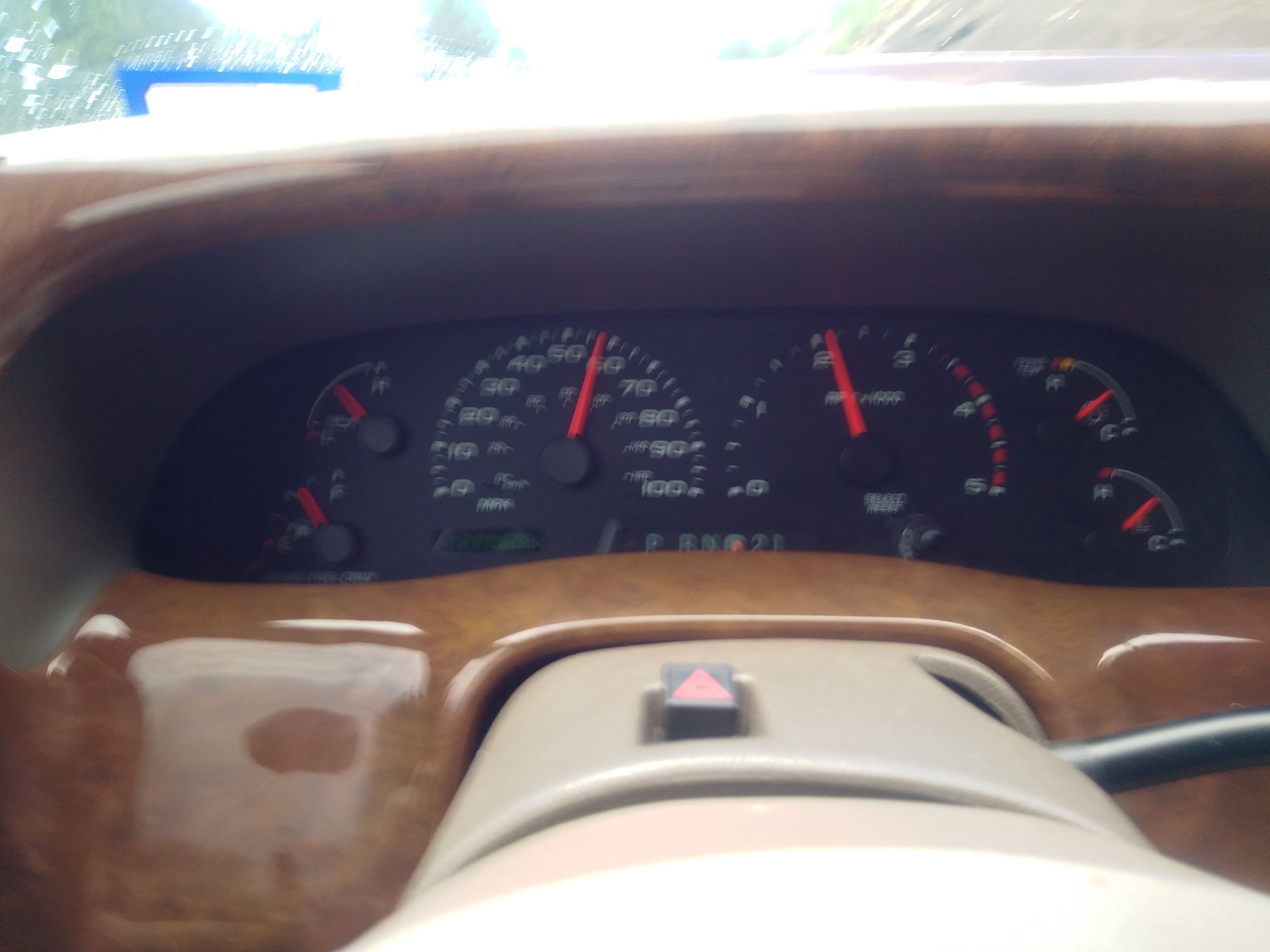

Having had a molested stock turbo, a BB drop in turbo and now a BW SXE, I can tell you with out question anything beyond an upgraded stock turbo is a waste of time and money unless its a T4 plumbed turbo. The BW SXE is the real deal. PERIOD.
Here are a few pictures of my gauges, mph, rpms etc on a 6% grade hill that I hit at 50 mph and finished at 62 mph. This is running a 40-45HP tune towing the below trailer at 8K foot of elevation in Colorado.
Look at the EGTs....1175 or so. Had this been any other turbo I've had in the past, I would have been in a heavy tow tune, 2nd gear and 45 mph and 1250 degrees.
