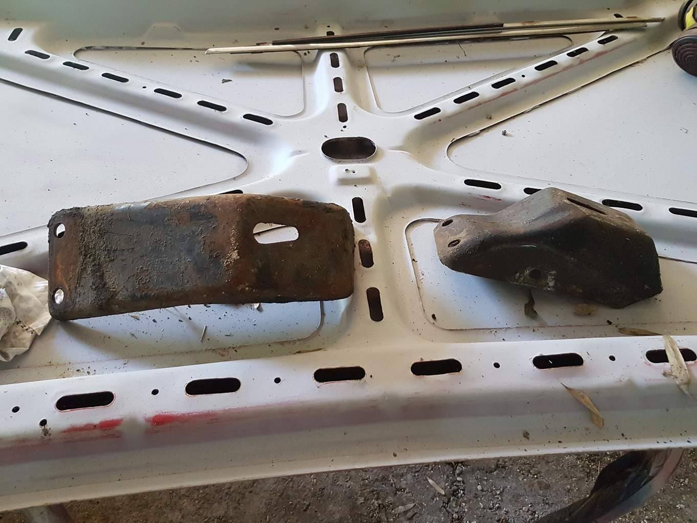

Hey Guys are these the right towers for our trucks as I may have a set here in Oz
Old Jul 2, 2017 | 07:04 AM
Gary Lewis's Avatar
Gary Lewis
Joined: Jul 2010
Posts: 32,875
Likes: 48
From: Northeast, OK
Clean them up and look for numbers. The ones for a 351M/400 say that on them. Dunno about what you have, but there may be numbers on them. What were they on?

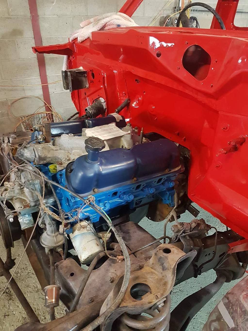

Gary I don't have them yet one of the guys on a Aussie site has them and it an Aussie delivered truck. I have asked him if they do have any numbers on them and I'm waiting to hear back from him. Here is another photo he has sent me. I just want to make sure that we ( Ford Australia )didn't make any changes to the chassis
Old Jul 3, 2017 | 07:17 AM
Gary Lewis's Avatar
Gary Lewis
Joined: Jul 2010
Posts: 32,875
Likes: 48
From: Northeast, OK
Makes sense. Good luck, as that would be an easy solution.

Thanks Gary How were these attached on the US trucks
Old Jul 4, 2017 | 08:21 AM
FuzzFace2's Avatar
FuzzFace2
Posts: 30,876
Likes: 4,116
From: Angier, NC
I am not sure but think I have seen it posted some of the v8's used rivets and bolts but when doing a swap like you will bolts are fine.
I am pretty sure the six are bolted in as I don't remember back that far on mine and too lazy (and hot) to go out and look.
Looking at the picture it is funny they kept the brake valve in the stock USA location. I don't remember what they did on the AMC cars they were imported there on that valve.
The steering box and linkage is that from another model made there?
Looks like they used plates on the fire wall to do the swap L to R.
Dave ----
Gary Lewis's Avatar
Gary Lewis
Joined: Jul 2010
Posts: 32,875
Likes: 48
From: Northeast, OK
Rivets and bolts. One side, the left if I remember correctly, is riveted. And the right is both riveted and bolted - on the same truck. I have no idea why both types of fasteners were used.
There were some problems with the rivets for the frame and suspension on these trucks, and Ford put out a TSB on the rivets and how to replace them: Frame Cracking/Popping - ???Gary's Garagemahal.
