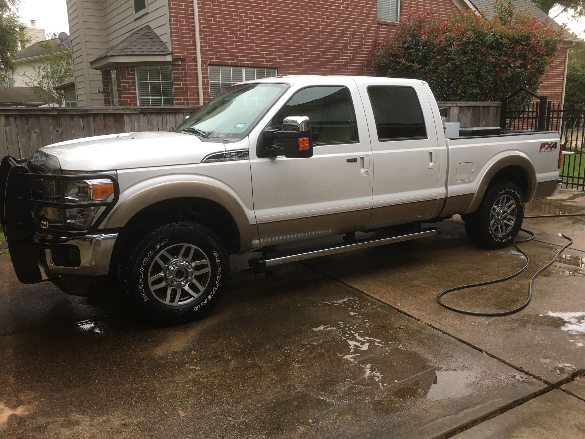

I'm not sure why people keep saying 20" wheels have no carrying capacity and extremely limited tire choices.
A quick search on tirerack.com gives me these results when searching for tires for a 2012 F250 4x4.
275/65/20 - 28 tire choices
275/65/18 - 32 tire choices
275/70/18 - 38 tire choices
If 28 tire choices doesn't get it done for you within the factory size I don't know what to tell you. This doesn't even include all the popular upsizes available for 20 inch wheels.
The carrying capacity of the stock 275/65/20 Michelin LTX AT2s that came on my truck is 3750lbs per tire. That is the highest rated carrying capacity out of all of the tire sizes Michelin makes for the LTX AT2.
Tire choices used to be hard to come by for 20 inch wheels, but it just isn't the case anymore. It seems like half the trucks and SUVs out there now have 20 inch wheel options that have allowed tire manufacturers to give us more choices.
