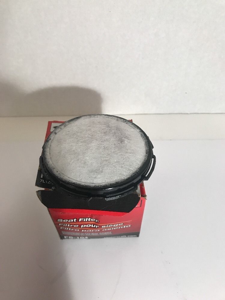

If you got the small hard plastic seat filters, pn FS106, they are the wrong ones. The seats in our trucks use the FS-104 filter. It has filter material in it.
Climate Control Seat Filter-HVAC Seat Filter MOTORCRAFT FS-104 | eBay

I pulled my out Friday. They had filter material. They weren't very dirty. I blew them out with compressor then shop-vacced them. I put the drivers on the pass side and the pass side on the drivers. I haven't noticed any change in the way the seat cools.

I looked on ebay for the part. Looks like the 106 has no filter material and the 104 has the filter material. I don't see what it is filtering without the material.
