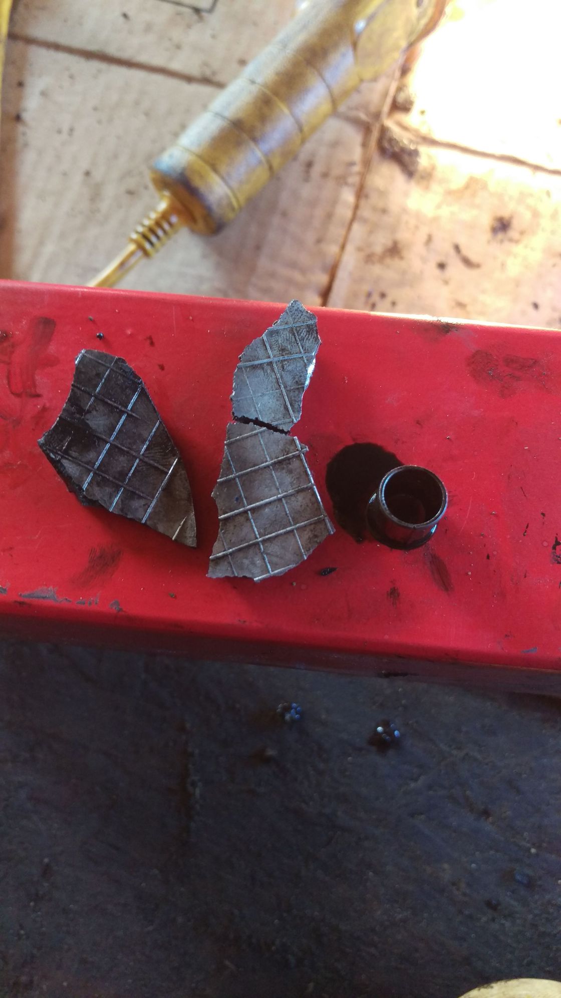

I'll get some better pictures asap. I was going to make a separate post for this but seeing as I will probably post more on my progress I figured I'd post here first.
