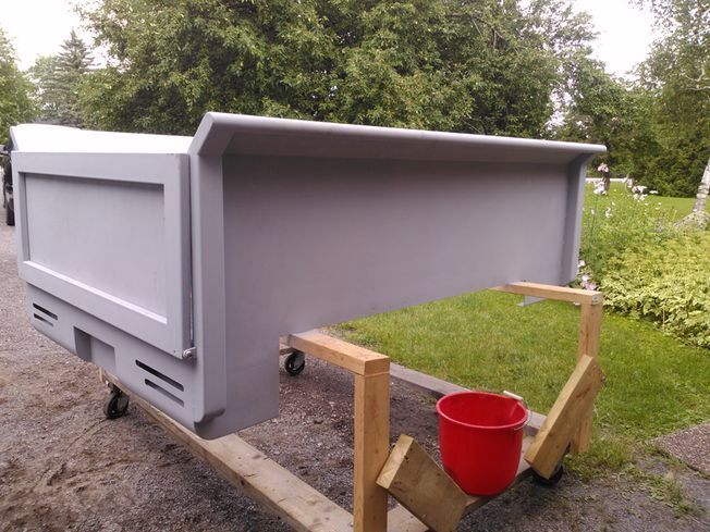

Forgot one important detail in this description. On the bottom of every stake pocket where it meets the box sides I cut in 2 slots approx. 1/4" x 1/4". That will allow any condensation to drip out, I hope.

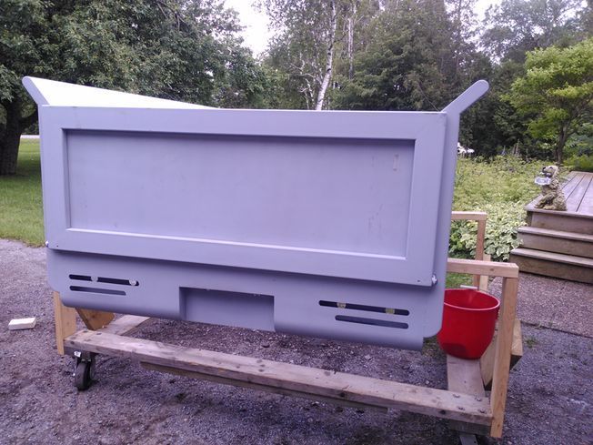

I have some time off this week so get to have more shop time then normal. So more updates. Next was building a tailgate. After several ideas and attempts I have a plan. The frame is built of 1 x 3 steel tube with a sheet metal skin. Cat the tube and epoxied in a connector nut.
Next was to weld the frame together and weld on the sheet metal.
More welding and grinding. Lots of practice here. and the final product.

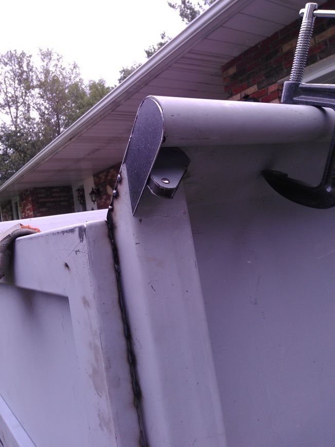

The original plan for the ends of the roll part of the box was to look like this. It was the best looking of different covers I tried.
And then there was that moment of inspiration. The ahhhh moment as such. What if I were to bend some metal and do this.
So four corners later, a bunch of welding, grinding and priming and the box looks like this.

Marten you have great skills, hard to believe it is your first use of a mig, or your first build of a bed box, it must make you feel good to say I made it.....
The top profile angle of the bed sides of the box,could you tell me the angle, as I have nothing to work off, or from other FTE members
greatly appreciated

Thanks so much Roger. It does feel great The goal is to do as much as possible myself, part for learning, part for cost savings. Worst thing I can do is mess up some material. For the most part it is not all that expensive but if I had someone do it all for me the labour would be a killer.
The angle I used is 45 degrees for that bend
