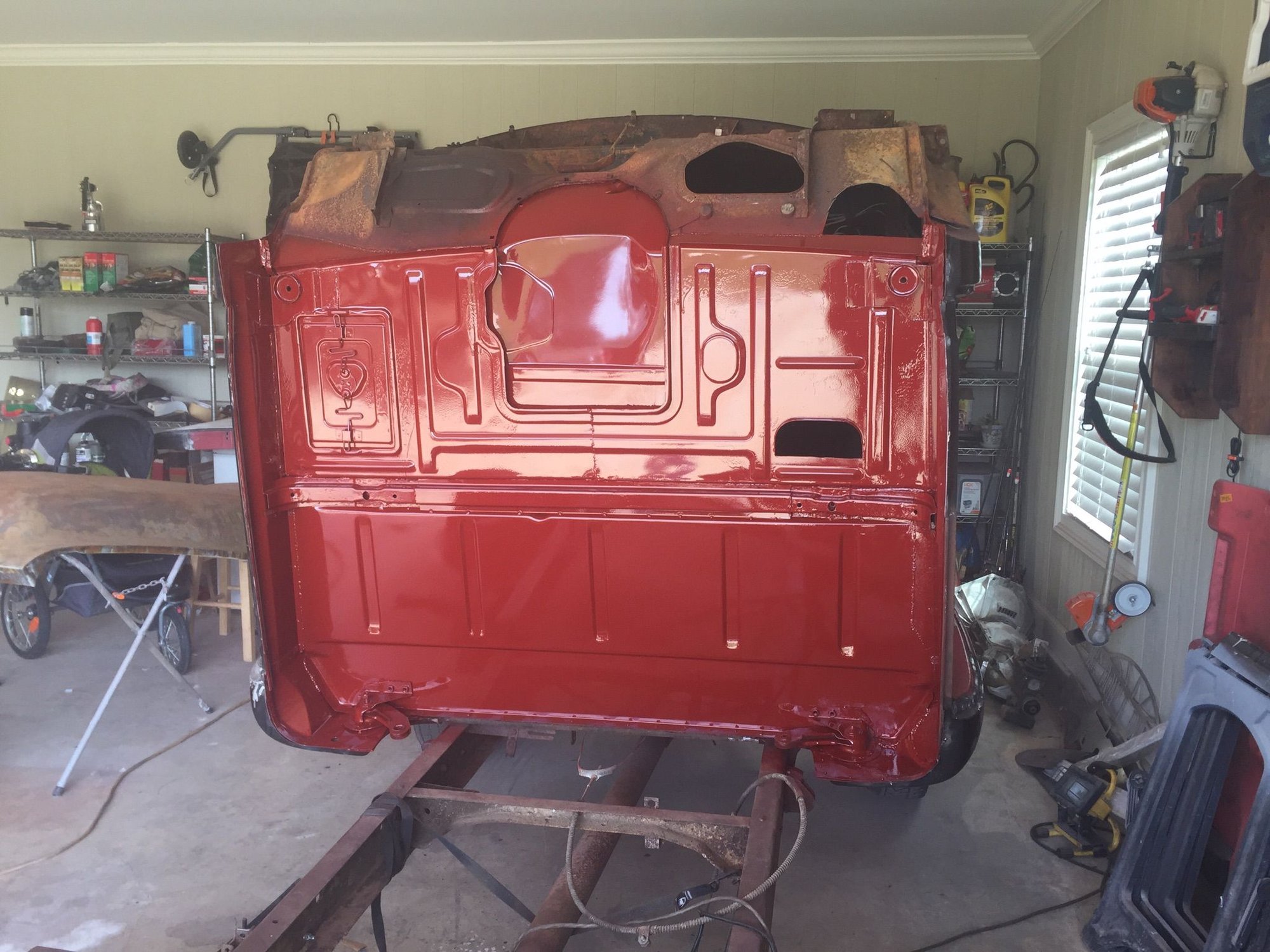

I finished up the floor pans this morning! All of the rust repair is finally completed with the exception of the firewall holes and the dimmer switch plate, I am fabricating a box to hold the dimmer rather than the little bowl that is formed in the firewall.
I was able to spray the floor in epoxy primer before I left for work today, when I get home tonight I will put a few coats of 3M Undercoating on it. I sprayed the epoxy very thick so it has a few sags in it, this wont show with the undercoating so I'm not sweating it.

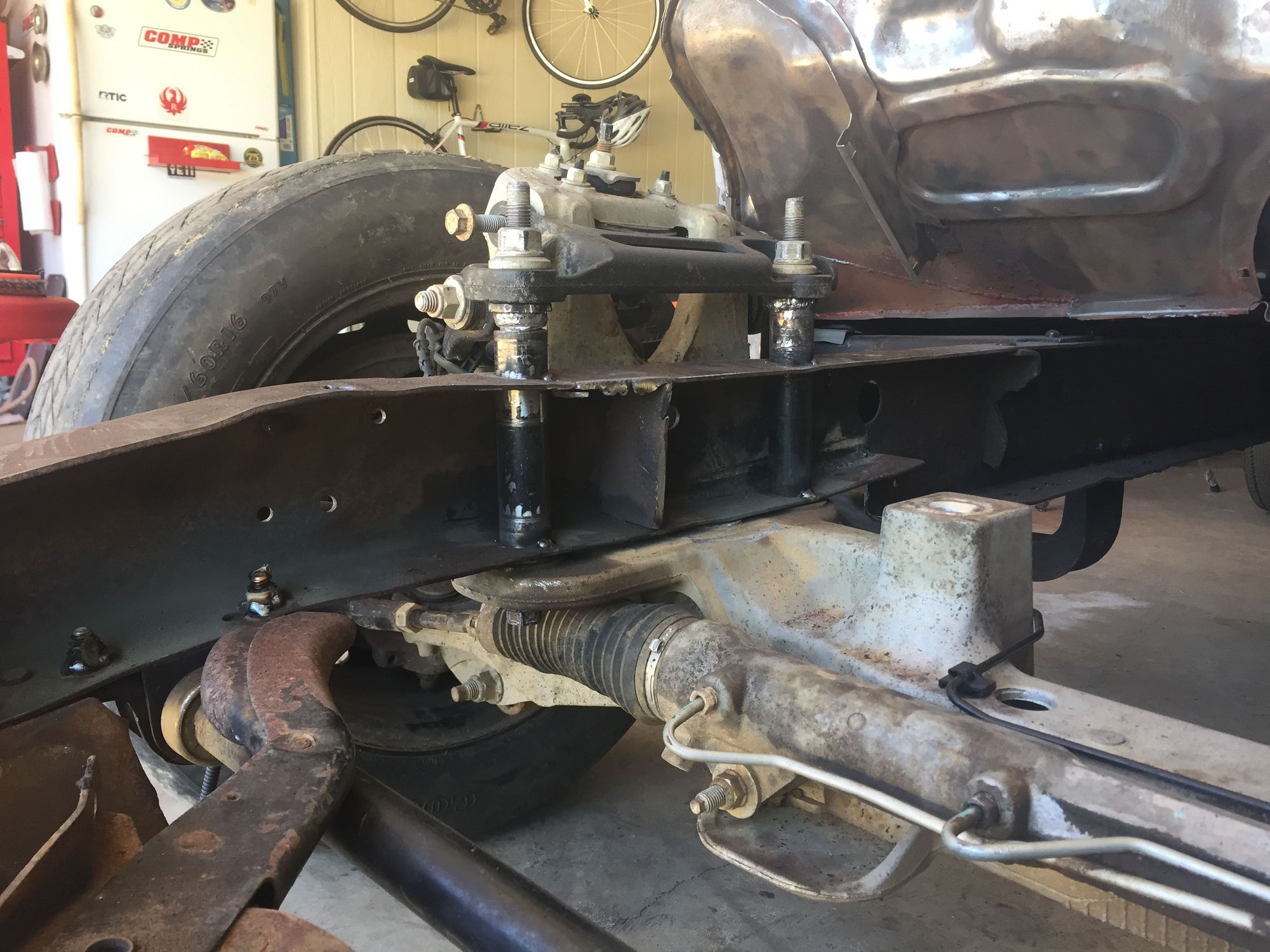

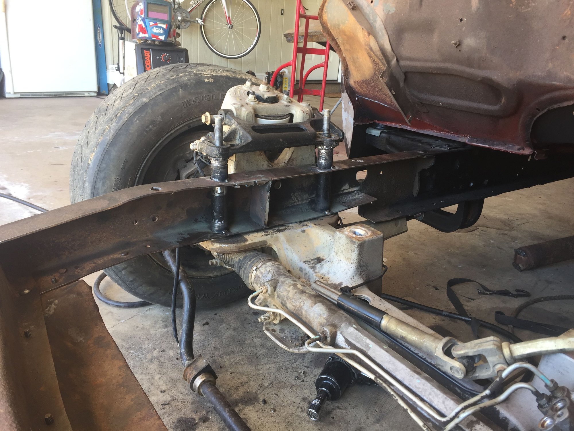

I also managed to get the CV IFS swap done this week, tomorrow I will finished up that project, mount the trailing arms and sway bar then box in the frame. I will also be installing new rear leaf mounts for the front and rear of the rear leafs. I also purchased drop shackles and adjustable mounts so I should be able to get a solid 4.5" out of the rear drop. I will be replacing the rear leafs soon too so I should get a little more out of it.
I'll post more pics after I'm finished tomorrow but here is a shot of the floor pans in SPI red oxide. I put nearly 11# of wire on this, definitely sealed up and possible holes!

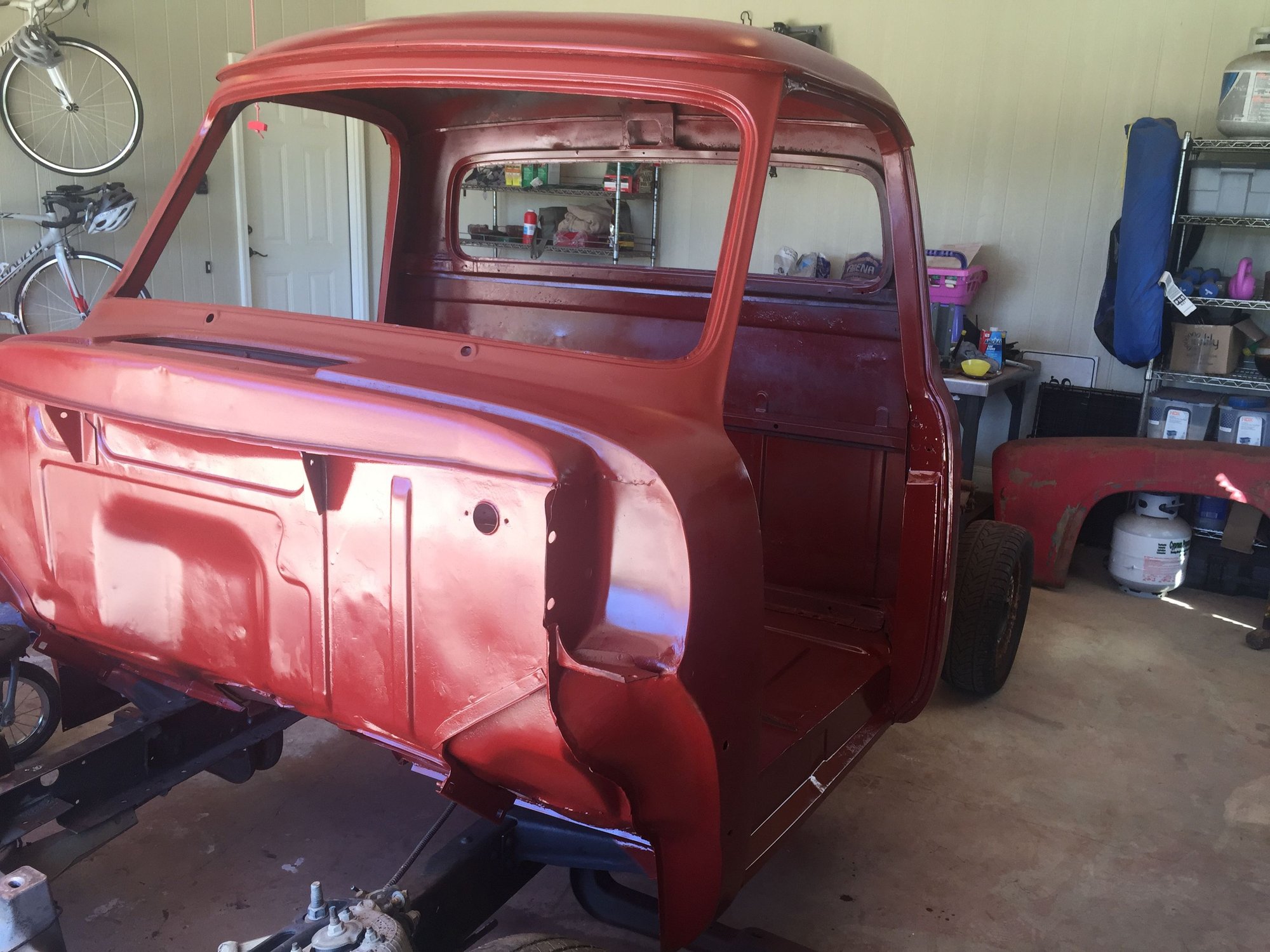

So I managed to get a lot done over the past few days... completely stripped the cab, washed it with soap and water, then acetone, then wax and grease remover, then got the cab in epoxy primer... same thing with the hood, de-rusted it, washed, and primed.

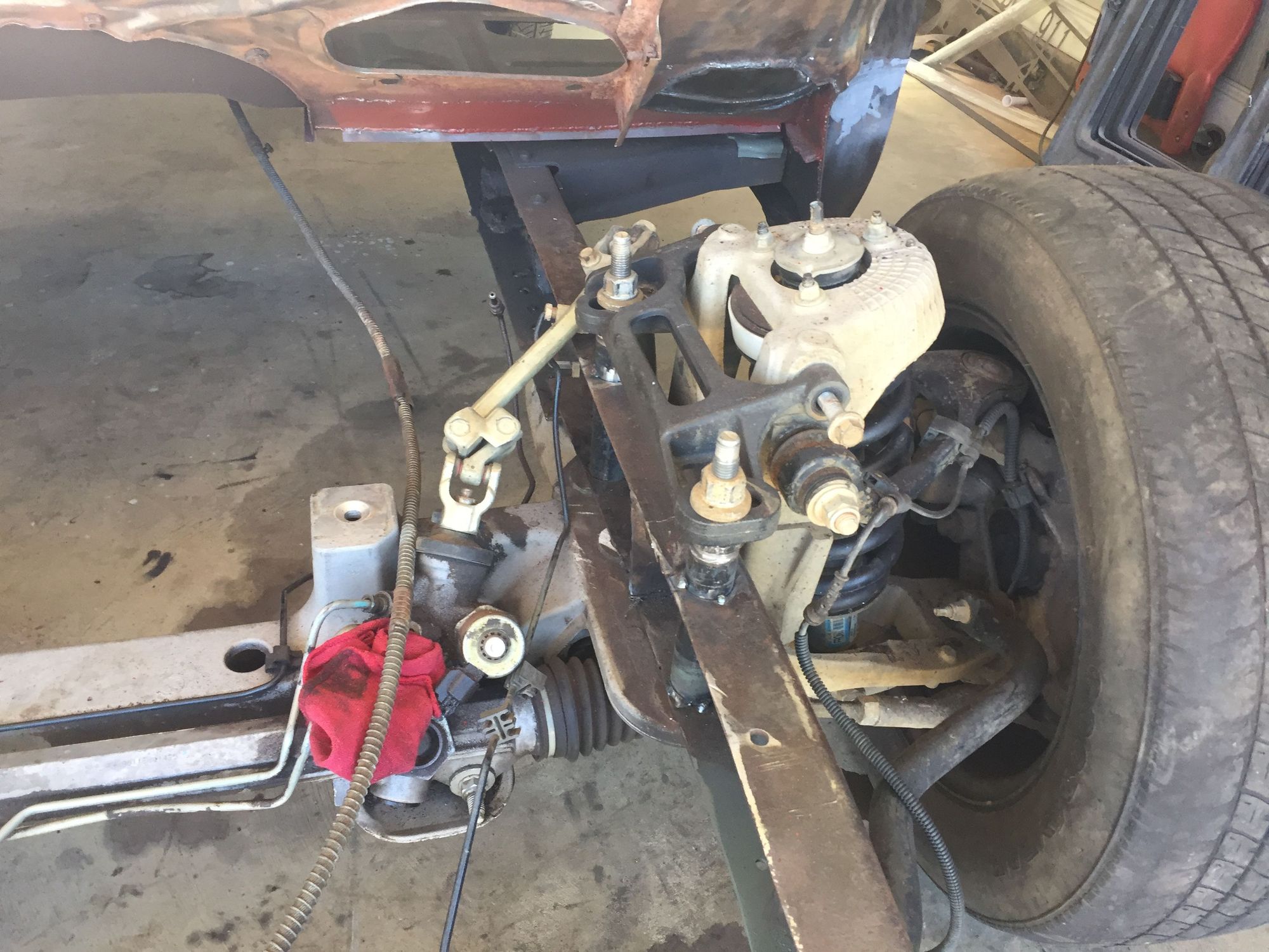

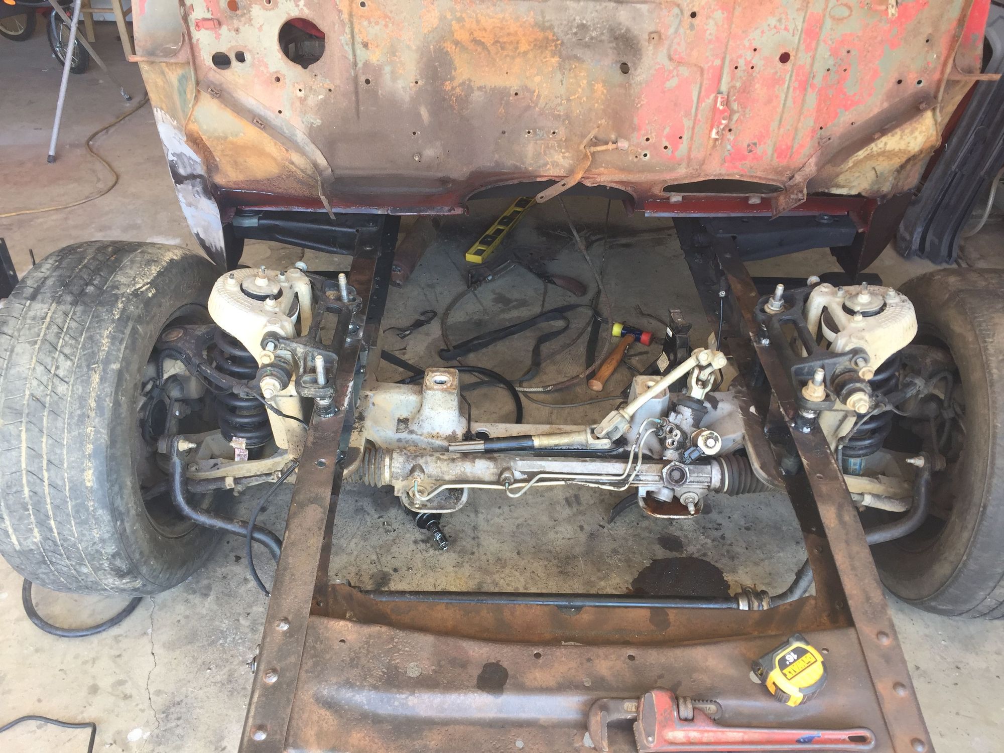

I also managed to get the CV IFS remounted... it wasn't quite square enough for my liking, it was off about 1/8", after some major adjustments I have it true within 1/32".
I also filled about 75 holes in the firewall and several holes in the dash as well as finished disassembly of the interior dash components...
Tonight I am going to get the cab and hood in 2k primer so I can start the painstaking body work. Here's a few pics to keep everyone satisfied.
The IFS is not welded out, it is hard tacked in place. I will final weld it once I get my plasma back, I loaned it to a friend working out of state for a few weeks. I need the plasma to trim the boxing plates to size since I had to notch the frame.

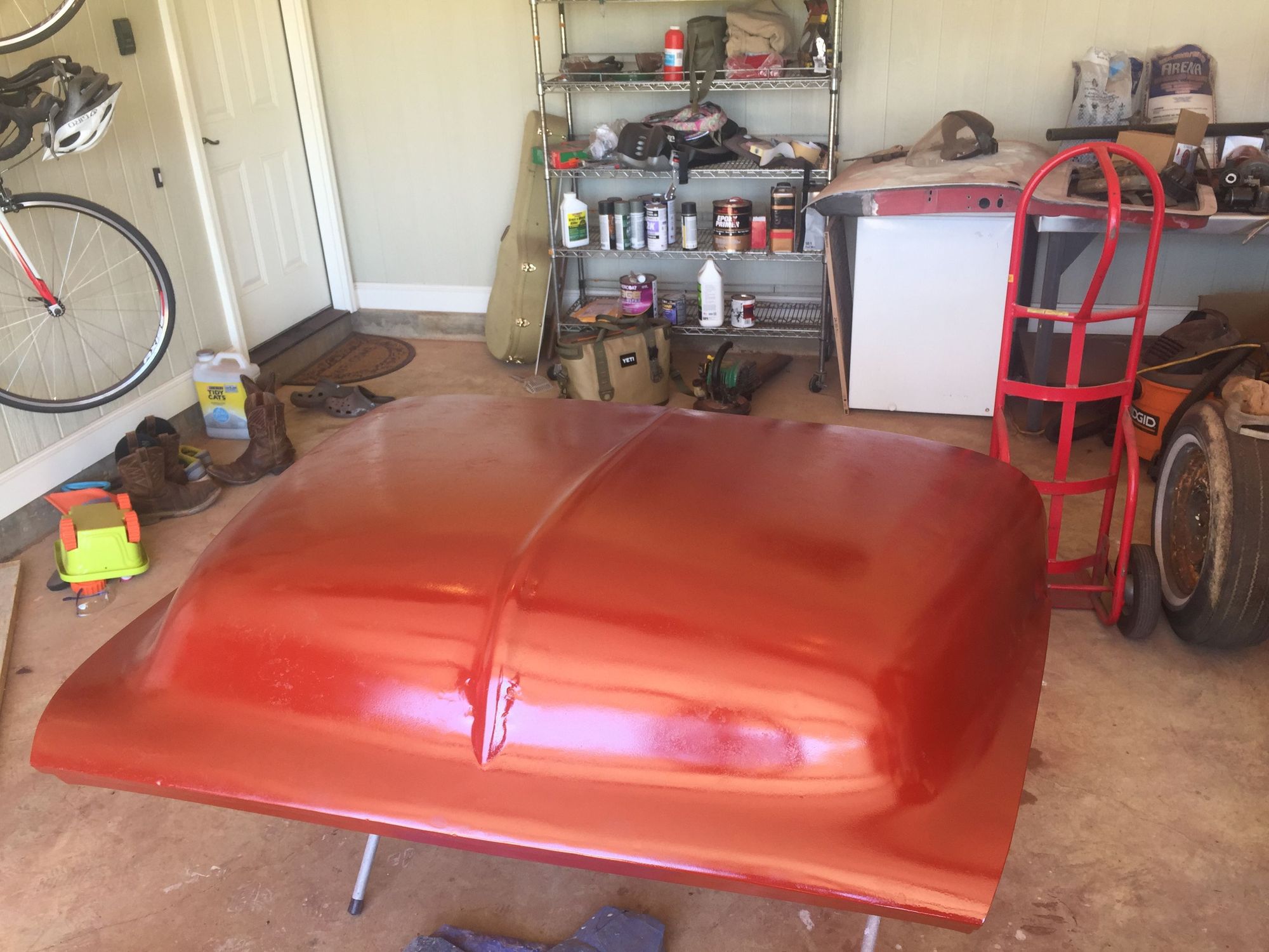

I apologize for not updating this post but I have been super busy with the truck and work. I've completed all of the cab and front end rust repair, installed the hood tilt, added custom inner fenders, added an ididit tilt column, finished the front suspension, and just got my 302 block back from the machine shop.
Hopefully I get to start on the engine build this weekend...
I've also primed everything in SPI epoxy, then a few coats of slicksand and starting blocking like crazy. The passenger side, hood and driver's fender is done in 220, the driver door, roof and back wall are currently being worked on. My plan is to get everything blocked out to 220 then put 3 coats of SPI 2K and let it sit all summer. This fall I will block it down to 600 then paint. I want to allow time for the 2K to fully shrink and im not in a hurry. This will also allow time for the drivetrain to be assembled and tested as well as the brakes. I plan on building the entire truck, then tearing it all down for paint.

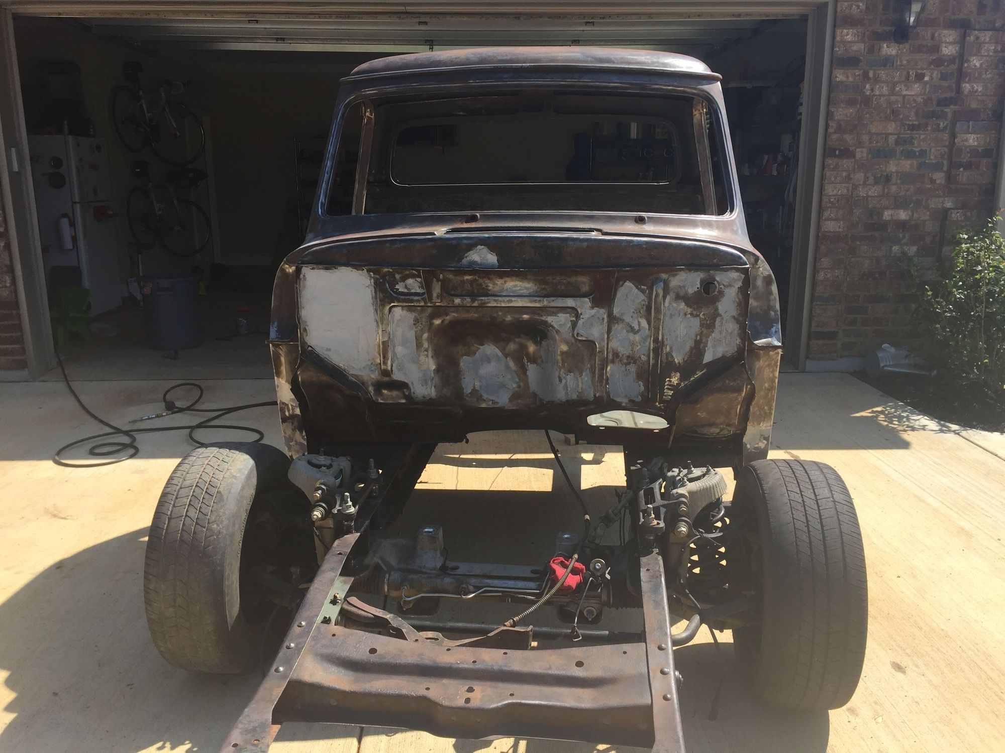

Following your build. Nice job! What has been your process to deal with de-rusting on body panels that are surface rusted to varying degrees? Your photo of the door bottom replacement shows a surface rusted area above the patch panel. I have been trying different products / methods including electrolysis (small stuff), white vinegar, Eastwood Fast Etch. I just bought a gallon of Evaporust. Thanks.

i started out using 40 grit pads on my da to strip all the rust and paint, I need up using several crimped wire wheel cups from harbor freight. That stripped the majority of the rust and paint. Then I soaked everything in fastetch from Eastwood for 24 hours, this turns any rust to a black hard scaled primer. After that I went over everything with the wire wheels again until I removed all of the rust, this took forever but I think I removed it all.
I also have have a small sand blaster that I use to shoot areas I cans sand or hit with a wire wheel.
once everything is stripped I was the panels with soap and water, then acetone, the wax and grease remover. I try to epoxy prime asap once dry.
