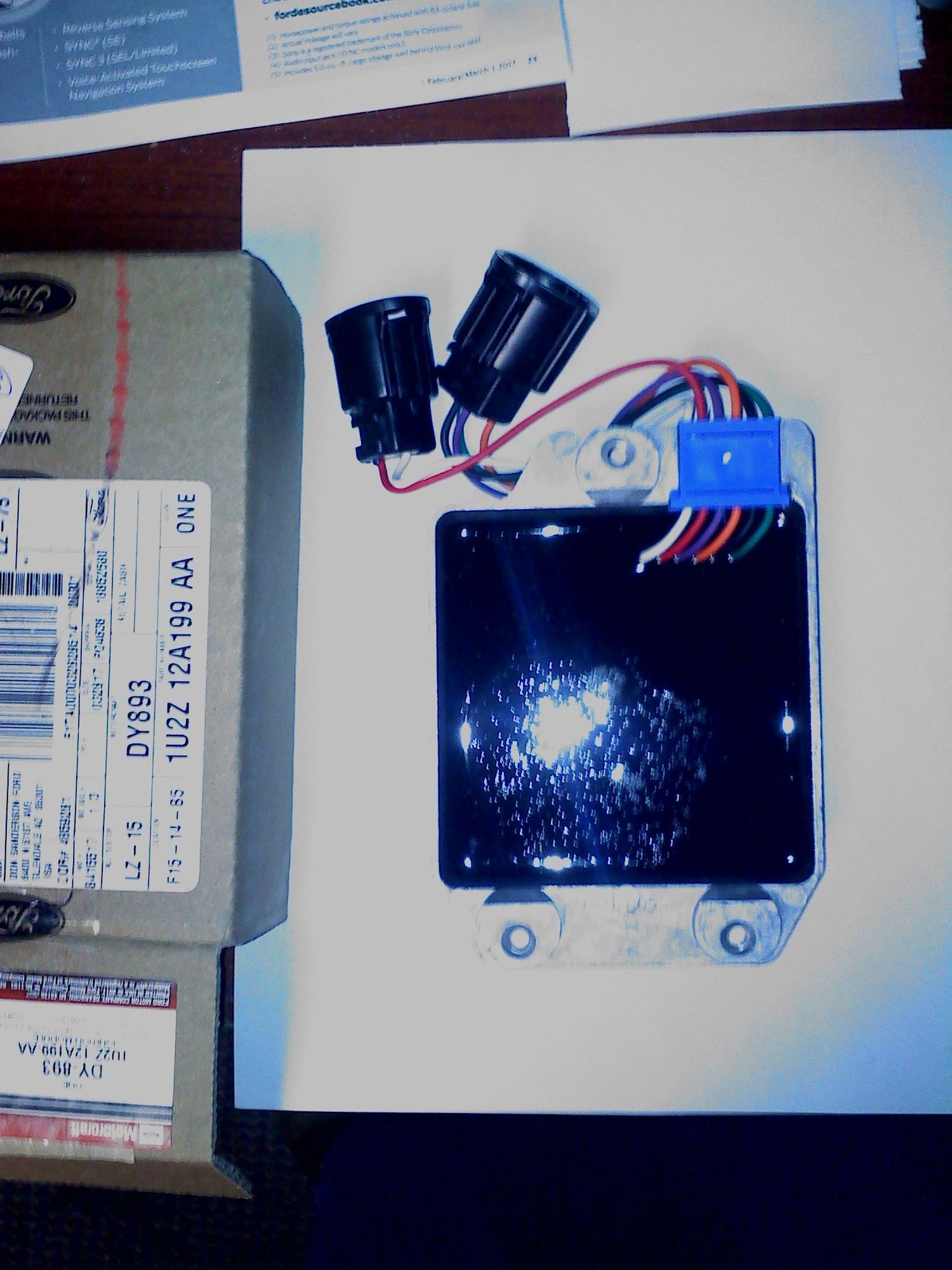

Here is what the Ford Part looks like.
Sorry about the flash and the size.

Nice...those are actually the ones I have, was hoping maybe to get the 2 pin for the red and white, but I can use any sealed 2 pin and cut it in.
