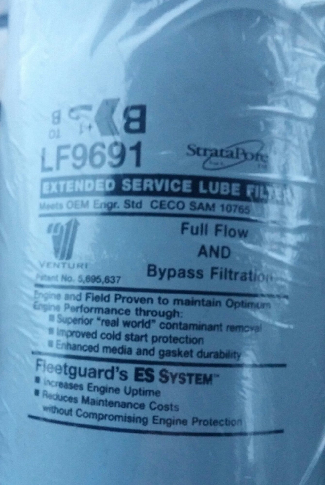

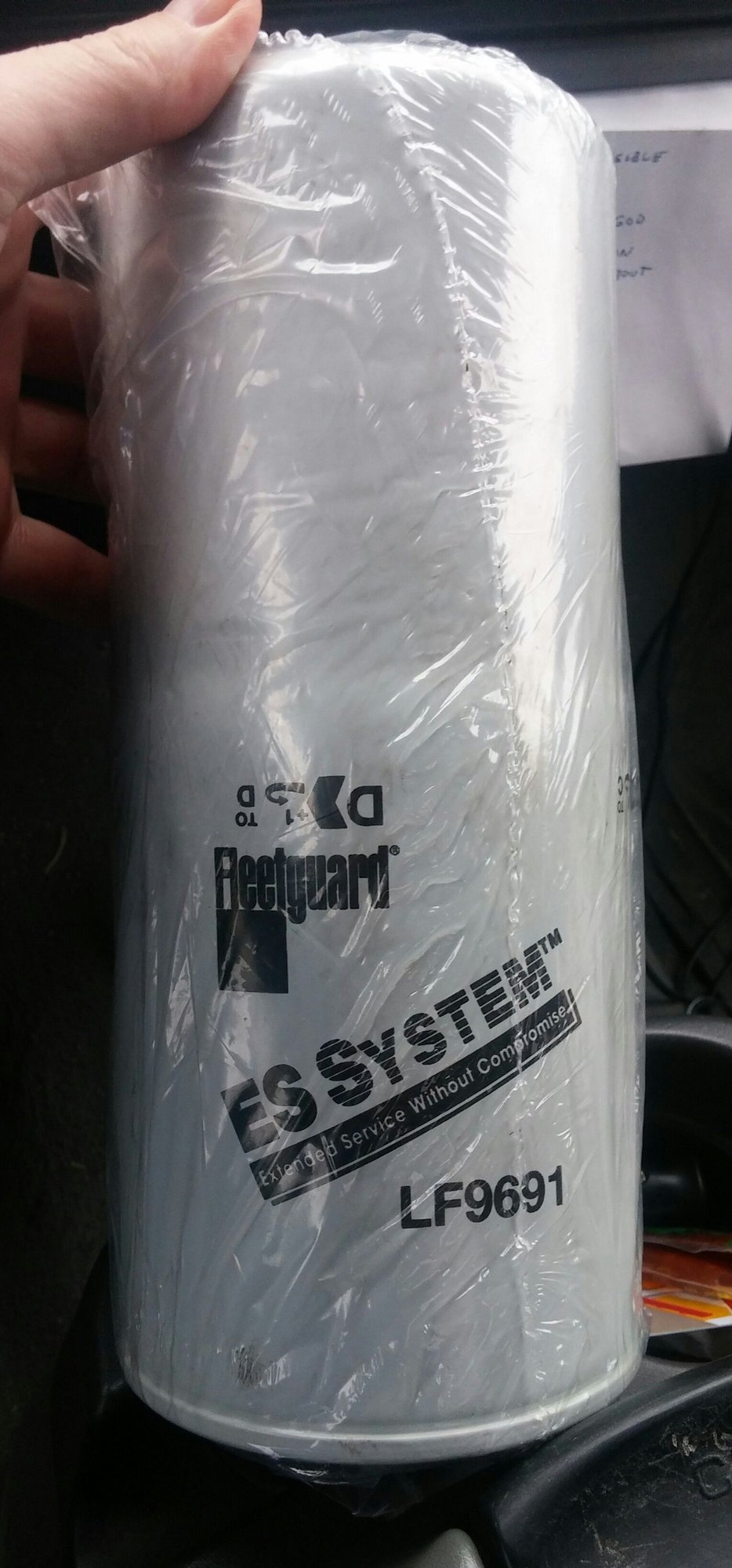

Chris this is supposed to be a great filter as well, and I found them for around $26 each.
LF 9691 Stratapore with Venturi

is this the same size as the DBL7405. It looks to be about the same length. When you change your oil, do you use 16 quarts?. I heard good things about these filters.
They appear to be the same size.
BBD
