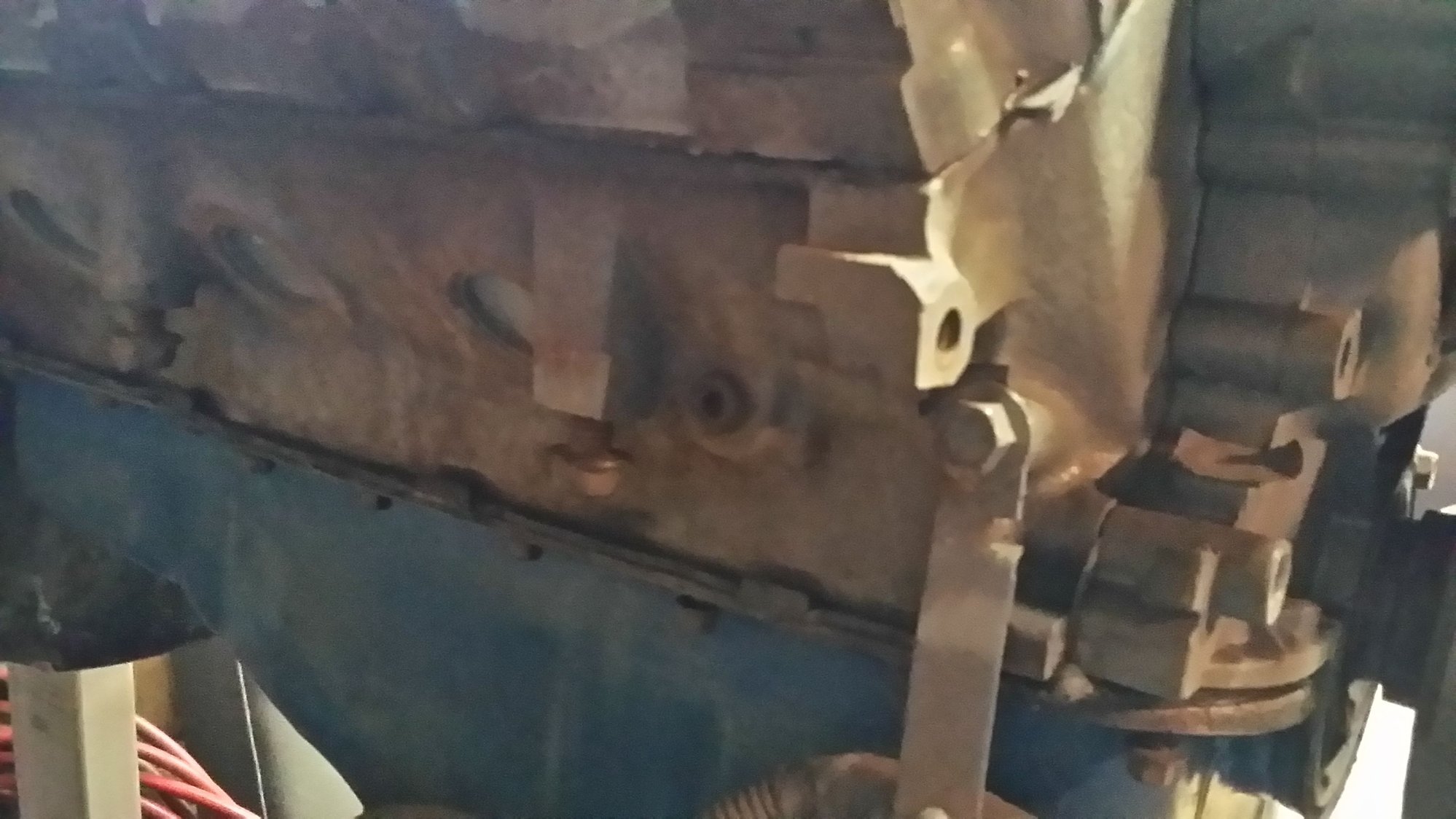

I don't know what engine is being referenced but, if you just take the lower radiator hose loose to dump the coolant, you MAY not get ALL the water out of the block (depending on what engine this is).
Look at the lower portion of the block, just above the oil pan rail, to see if there are any NPT plugs screwed into it. If there are any, remove them to get the remaining water out that's sitting at the lower portion of the water jacket.
This is an example of the NPT drain plug at the lower right front corner of a '90 5.0L engine. There's also another one at the lower left rear corner of the block.
