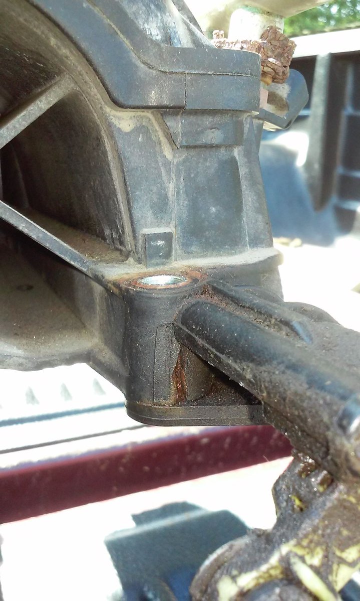

Found the vacuum leak. it was a hose clamped to a metal pipe close to the vacuum booster that went to the vacuum booster. The clamp crumbled in my hand, visually it looked fine. The same thing just happened with a radiator hose clamp. I replaced ALL hose clamps, a little late though because the top radiator hose clamp cut loose and blasted everything under the hood with anti freeze. Now I have electrical problems; TAC PCM when it rains it pours.

OKAY so I finally got it down to two error codes P0171 and P0174 and after reviewing my freeze data determined the air leak is the problem, and it is a big one. Also the water pump pipe is all rotted out too. I don't know if I can cut it and add gas line or buy a new one? The new intake will be here Thursday 15th
