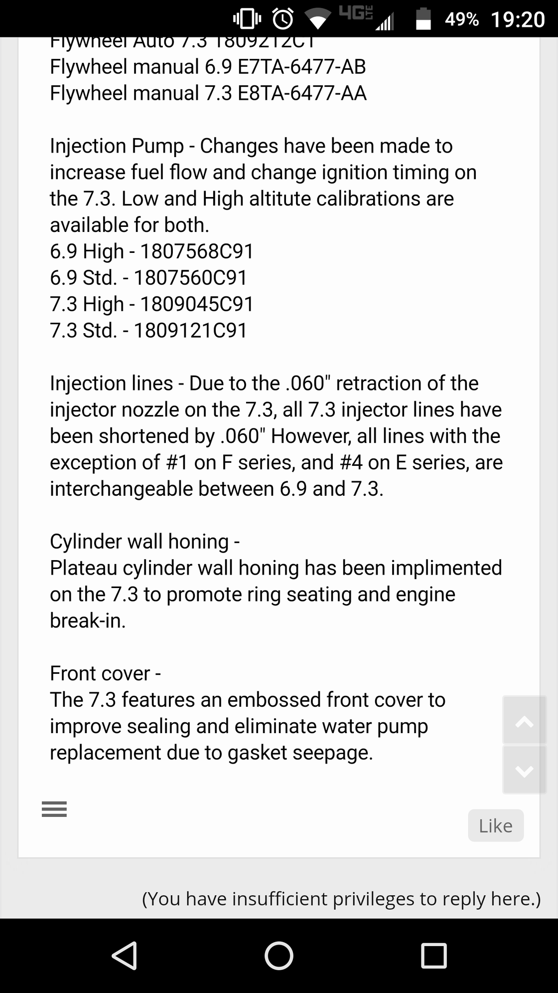

I forgot where I read it, might have been here on FTE, but I've heard that there is a slight difference between 6.9 and 7.3 injection lines. The slight difference can mess with timing. I'd stick the 6.9 lines on and see if that changes it. I could be wrong though

IDK. Could be, but all the replacement lines are for both engines are the same. If they are different, then wouldn't there be two sets of lines for sale?

Might be blasphemy, but oilburners does have good info. Screencap is from a post there about the differences between the 6.9 & 7.3

I guess even if the lines are .060 shorter, I'd assume that all someone would need to do is pull the timing to match the variation in pressure produced by the IP, so that the stroke is matched when it matters. Maybe tinkering down to 3 degree BTDC might in order.
