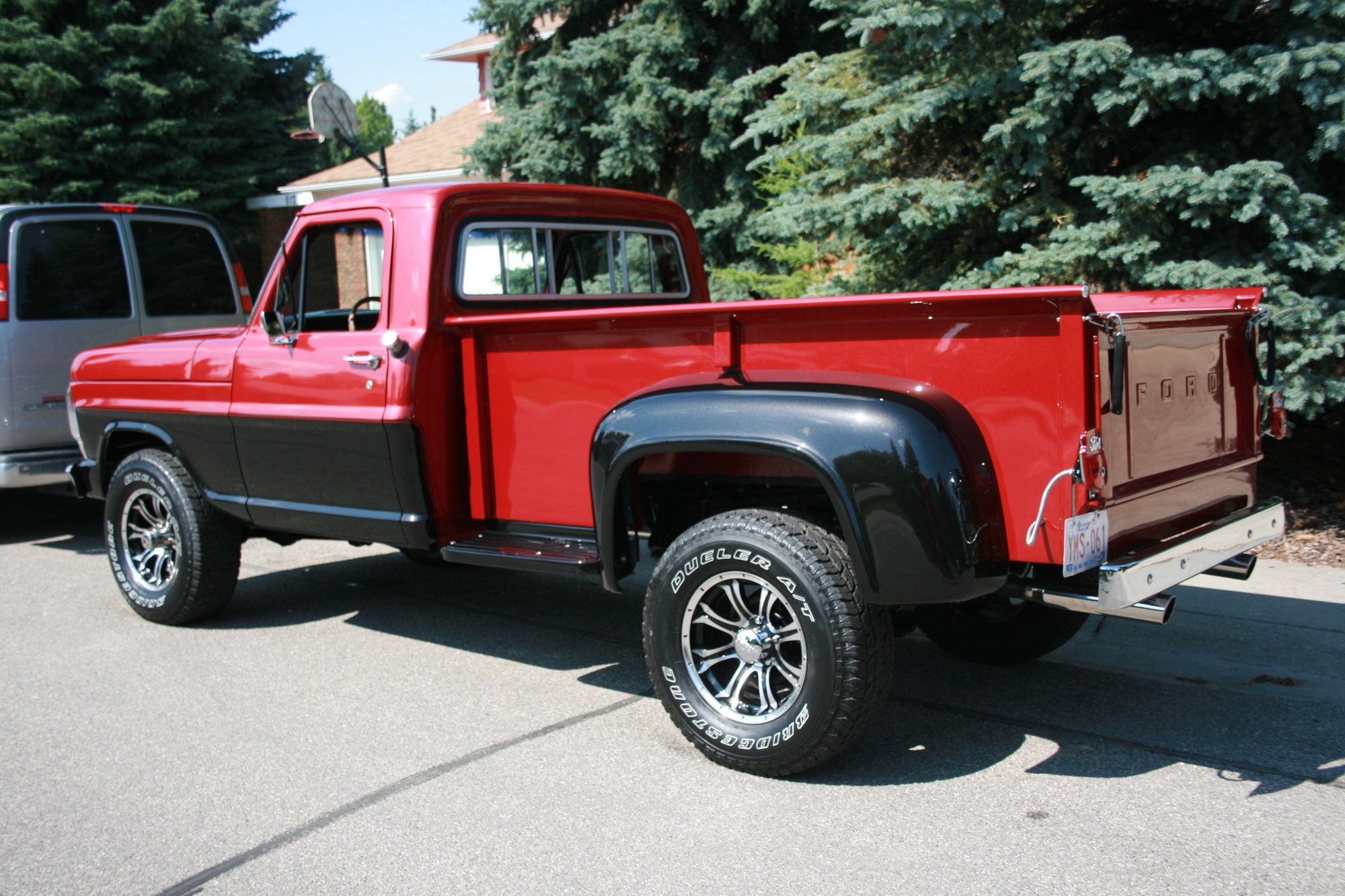

Arguments about firearms and nomenclature aside, I find it interesting when I compare my 69 Flareside 4WD to the ones in the pictures that the sides of my Flareside box are taller than the Fords in the pictures.
Is yours a F-250 with an 8 foot bed? My '69 F-250 4x4 has a flareside bed like yours, longer and taller than the beds on the F-100s.

Mine is an F100 4WD with an 8 foot bed. Perhaps Bill (NumberDummy) has a thought on the differences in bed heights.
It has to do with the wheelbase and or F350 or not. 3 different pairs of bedsides listed for Bumps.
57/60 F100 110" W/B and 61/72 F100 -114" and 115" W/B (body type 83)...part numbers C1TZ8327840A and C1TZ8327841A.
57/66 F350 (83) and 67/72 F350 135"W/B (83)...part numbers B7TZ8327840A and B7TZ8327841A.
67/72 F100/250 131" W/B (83)...part numbers C7TZ8327840A and C7TZ8327841A.

It would be interesting to know the specific dimensions. Do you think the F350 box is shallower? My one regret from the restoration was I didn't cut the box down so it lined up with the character line on the cab. I think the shorter box looks more proportionate.
