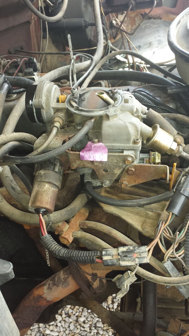

As David mentioned, the original carburetor from the factory was connected to the computer, but what you describe makes me wonder if that carb is still there. Can you please post pictures of the carburetor from all angles, and one of the distributor, too? Thanks.

Got some screws today! Where the air filter bolt to the carb stripped out a while back so that top piece is off but it's the regular Carter yfa 1 barrel. After checking at a better trusted parts store the choke is suppose to be an electronic one hooked to the computer as you both said. That choke is $68! Is it worth that much? or should I just keep the bimetallic one I have now. It does have the exhaust heat tube to the choke.

On the positive side, that's a feedback carburetor you have there and the distributor is also original, so at least that part hasn't been mucked with by a PO.
I don't recall the automatic choke wiring on one of these things but here's the EVTM from Gary's site and you can look up the wiring in there; if it was computer-controlled, I'd expect it to depicted under the Engine Controls section:

oh and I did find the plug for that electric choke. It's actually at the bottom of the one picture above!!!!
