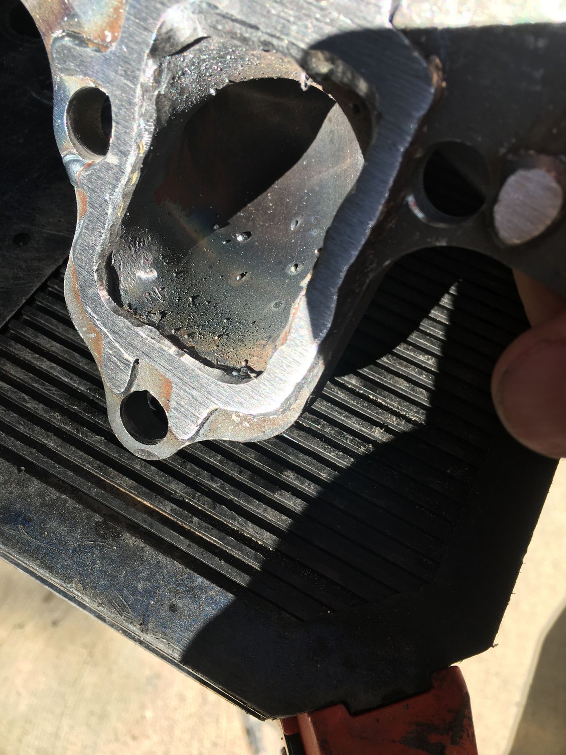

Well, I have a set of what I think were cheap Flowtech headers (bought them 10 years ago so don't remember the brand but they were not high end). They wrap around the engine mount on the passenger side.
When I built a new 445 for my truck I went with BBM heads - Cobra Jet style exhaust ports didn't match up with the Flowtech headers so I had to find something that would work. I did notice that the sealing surfaces on the Flowtechs were poorly aligned and in fact one of them was tilted at about 10 degrees off square. To be clear, the only reason I went with the Sanderson headers is the CJ ports combined with fit to an F100.
I got my new Sanderson FF427 headers - ordered uncoated in case I have to do any banging on them - and was underwhelmed by the finish quality:
I won't have a chance to try and fit them until next week, I'll be able to give better feedback then. I did get in there and grind off the lumps. I run a stock starter so hopping fit isn't an issue.
Incidentally - found this interesting:

Wow.....ouch.
I had to do a little flat filing on the Hookers to make sure they would seal properly, but they didn't look anything like that !!!

I did write to Sanderson and here is their reply. The tech support person's comments are correct, and as per the video on banging the crap out of them, I knew this. I just can't abide the idea that stuff was inside my headers. I suggested if they intend to provide a nasty finish they should put a picture on their site!
Let me attempt to address your concerns.
First, that is the plain steel version of the header. The plain steel headers often require additional prep before a finish is applied. This helps keep costs down, and allows those customers who desire to put in a bit of extra individual effort that opportunity. The coated header receives considerably more prep. However, the exhaust gases don't care what the finish consists of. Testing a header with weld splatter versus one completely polished will show no difference on an engine dyno. In fact, the exhaust flow also does not care whether or not the ports match exactly until the airflow reaches speeds consistently above 6,500 RPM.
If a customer is looking for every last bit of horsepower for their application, they would not be using this style of header --- one for street rods and classic applications. The average RPM and type of use for a street rod, or any application spending most of its time below 4,500 RPM does not have the same requirements of an application that spends a majority of its time at WOT (wide open throttle).
These concerns are sometimes difficult to explain to some customers due to what magazines and reviewers---who often have little to no real experience----print, claiming otherwise. What is a concern is proper flange sealing, welds that hold and don't leak, improvements over factory exhaust manifolds, thermal control, and having a header that fits a vehicle's chassis without having to take a hammer to it. Although I understand that some individuals feel that the weld splatter is a problem---it's actually not.
