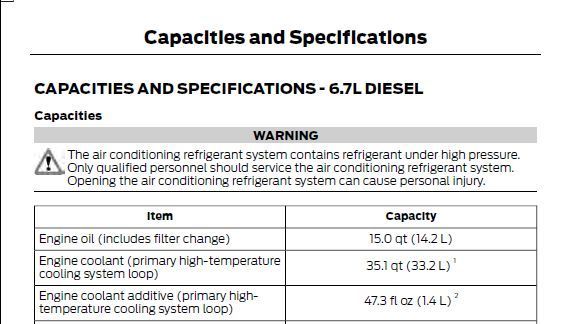

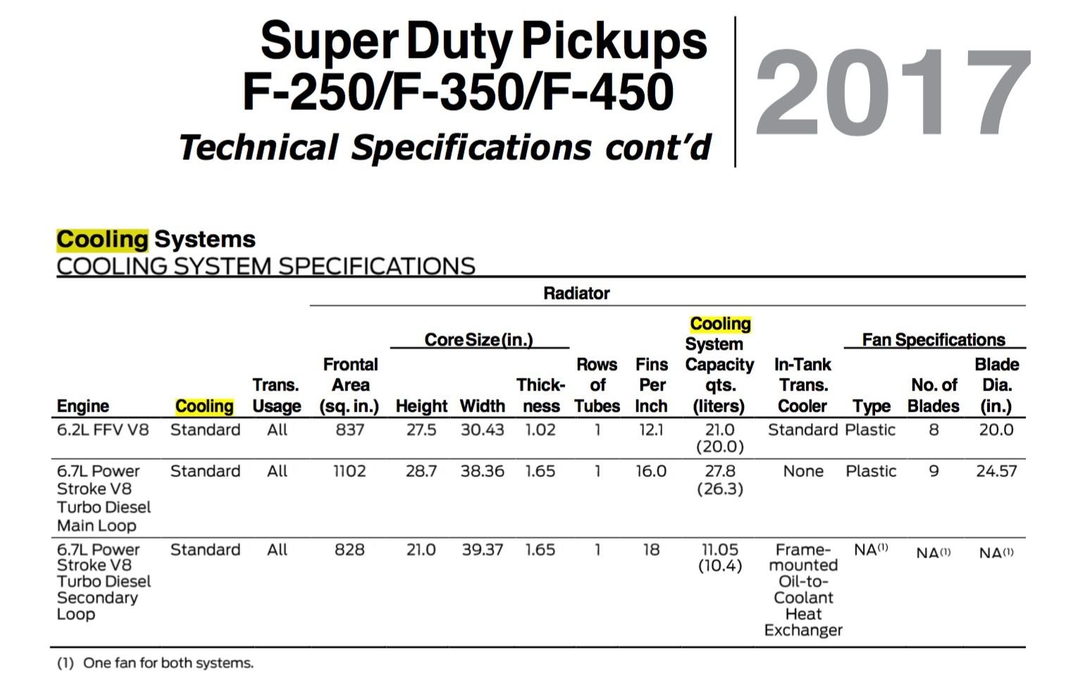

Originally Posted by troverman
No idea where you guys are getting the cooling specs. The 2017 Fleet dimensions guide states the same exact 38.85 quarts as the previous generations.
The 50 quarts number is the total of both the primary and secondary systems. This from the 2017 owner's manual:
Well, one or the other is lying!
I knew about the new fuel pump and injectors.
I'm guessing it's the fleet information you're getting. According to the 2016 manual, the primary loop has 30.3 quarts of coolant. The fleet info you got shows the 2017 at 27.8. If that's true, the new truck will be using LESS coolant than the 2016. I seriously doubt it.
Well, I hope your document is lying. I'd prefer the extra volume stated in the owner's manual. What does the fleet doc say about oil capacity?
It doesn't state oil capacity that I can find. I like the extra capacity as well, but I'd be kind of surprised. Where is the extra 3 gallons of coolant being held? The overflow tank is exactly the same. Maybe different radiators?
Oil Capacity in Users Manual:
