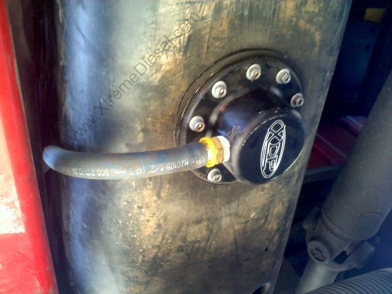

You could always add fuel sump for easy draining, plus you could get all fuel out of the tank instead of leaving a gallon or two in the bottom if that's your kinda thing. The downsides are they could get hung up on stuff offroading and cutting a large hole in your tank.

That looks really great! I wont be wheeling this off road too much that is what the other toys are for. This truck will just be used to get me to the playground.
