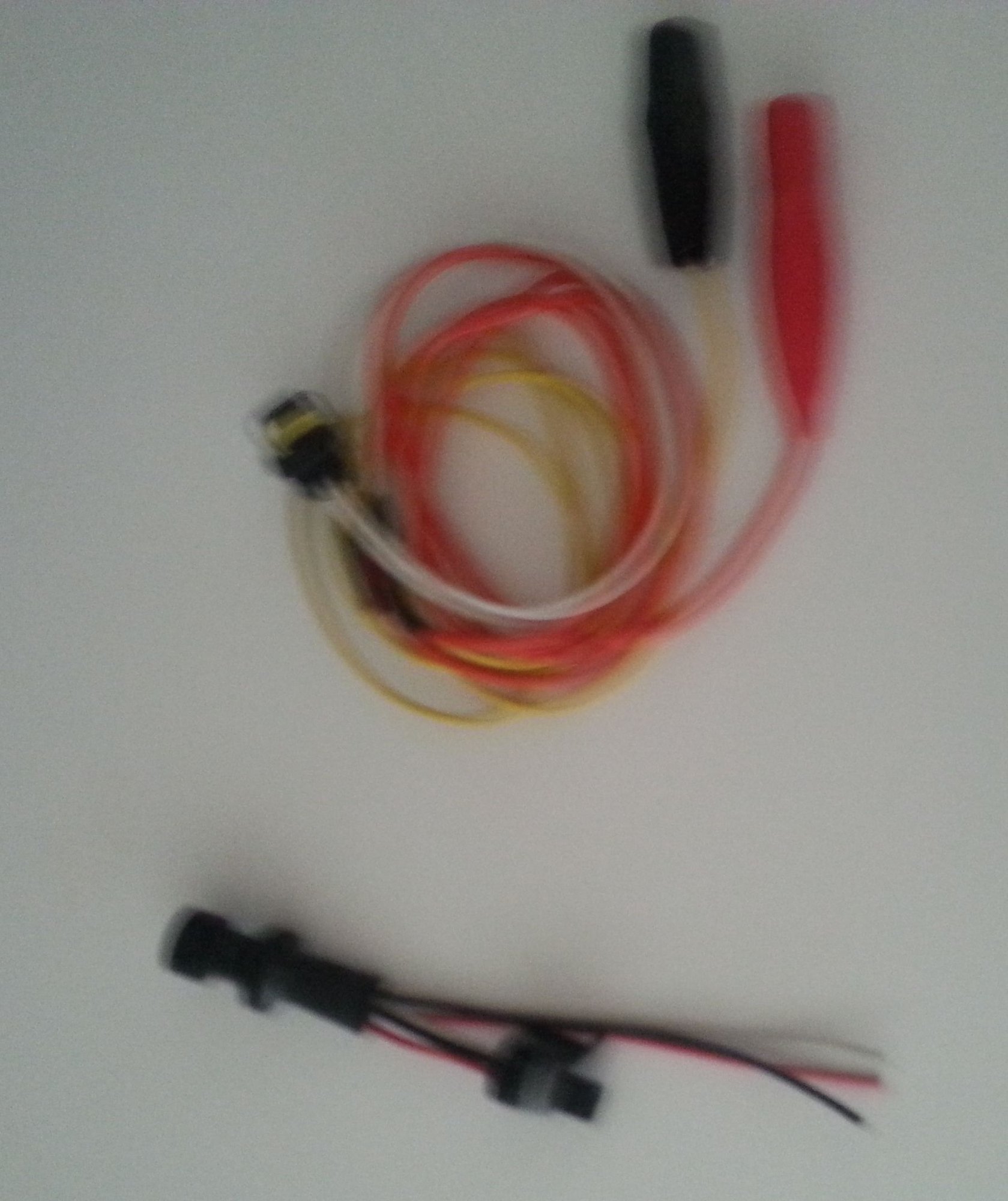

The IPR Test "Harness" is an electrical connector for 12 vdc which open the valve all the way while performing the test. It has two battery clips and a IPR Electrical Connector on the other end.
The commercial tester screws into the HPOP.
I took a photo (if you can call it that.... hey I'm OLD). It shows the IPR Harness and the ICP Harness. You can also use the IPR Harness on the EBPV to see if it moves easily.
