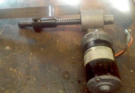

Does anyone have a source for the motors used in Ricon's 6 way seat that won't require a 2nd mortgage? I'm assuming that all three should run smoothly and no unusual noises. My lift motor sounds like a box of rocks, even when run with no load. The part# for the motor and worm drive is PS-1140.

Good news! I called Danny at Motion Systems and he thought they'd be able to support it with a flat rate rebuild. Not much to it, the worm gears and the "Ballnut". This was new to me and I googled it. They're recirculating ball bearings within the "ballnut" to distribute the load and add life. Works a little like a steering box only much smaller.
I appreciate the lead Jimbo. ps, I do have a lift, a Ricon UltraLite. It's driven by what appears to be, a Ford starter motor with wormgear reduction. That feeds #80 chain to deploy or store. Clever system, good for 600lb.
The lift motor from my Ricon R1208 seat.

They gave me a cost of $125 to go thru the unit. With today's cost of labor and parts I believe they are doing it as a courtesy more than anything. Danny called me yesterday to say the motor/gear drive had arrived and should be on its way back to me later this week. A really fine company with a heart.
