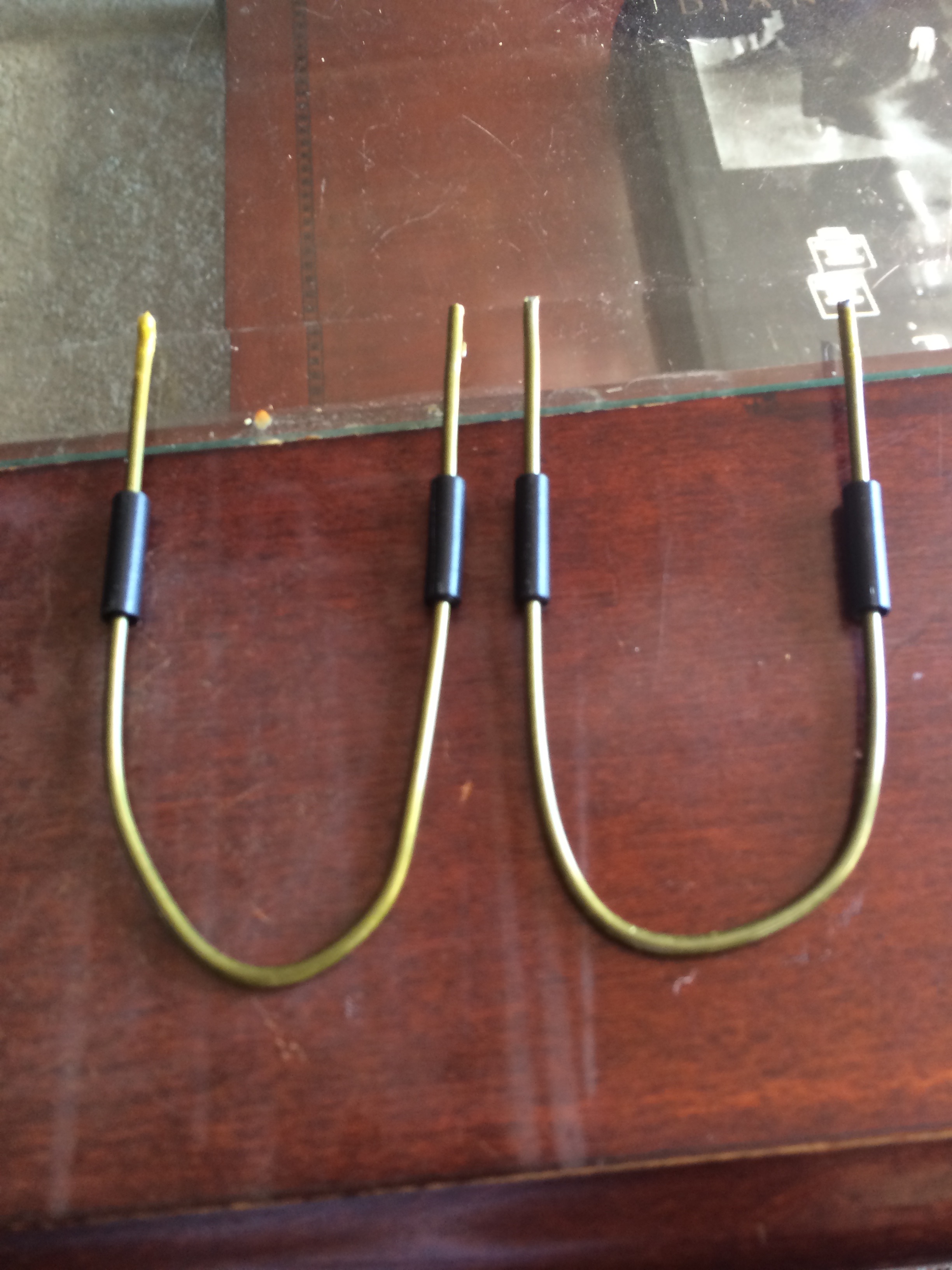

I found a video that shows how to take the Jensen out without special tools. There are four small holes in the front in which some snipped pieces of coat hanger can be inserted to release small catches that are inside, then you apply a bit of sideways pressure on the wires and the radio will slip right out. I know my model has those holes. I'll have to try that tomorrow, it'll solve the whole dash removal issue. There is quite a bit of room around the radio space.

That's basically the same way the factory radio is removed too. Not sure why I never could get mine out but, again, I was able to remove the dash and then remove the radio by hand. I made the coat hanger tool too, just didn't work for me. Good luck and keep up posted.

Attachment 151007
Wow, took my homemade (clipped metal clothes hanger ends) tools and inserted the four points into the Jensen and it came out like a greased pig
Now I have all kinds of room to fish around behind the dash, without need to actually remove the dash cover.
I was surprised to see that Ford left a wired receptable in the 'blank' spot where I need/want to put the Auber gauge (below the fan switch). Was hoping it was totally empty as in JWA's photo. I don't think there will be an issue removing that receptacle, as it isn't doing anything. But, probably a good thing I didn't just go hog wild with a dremel cutter into that space from the outside and start cutting hidden wires.
