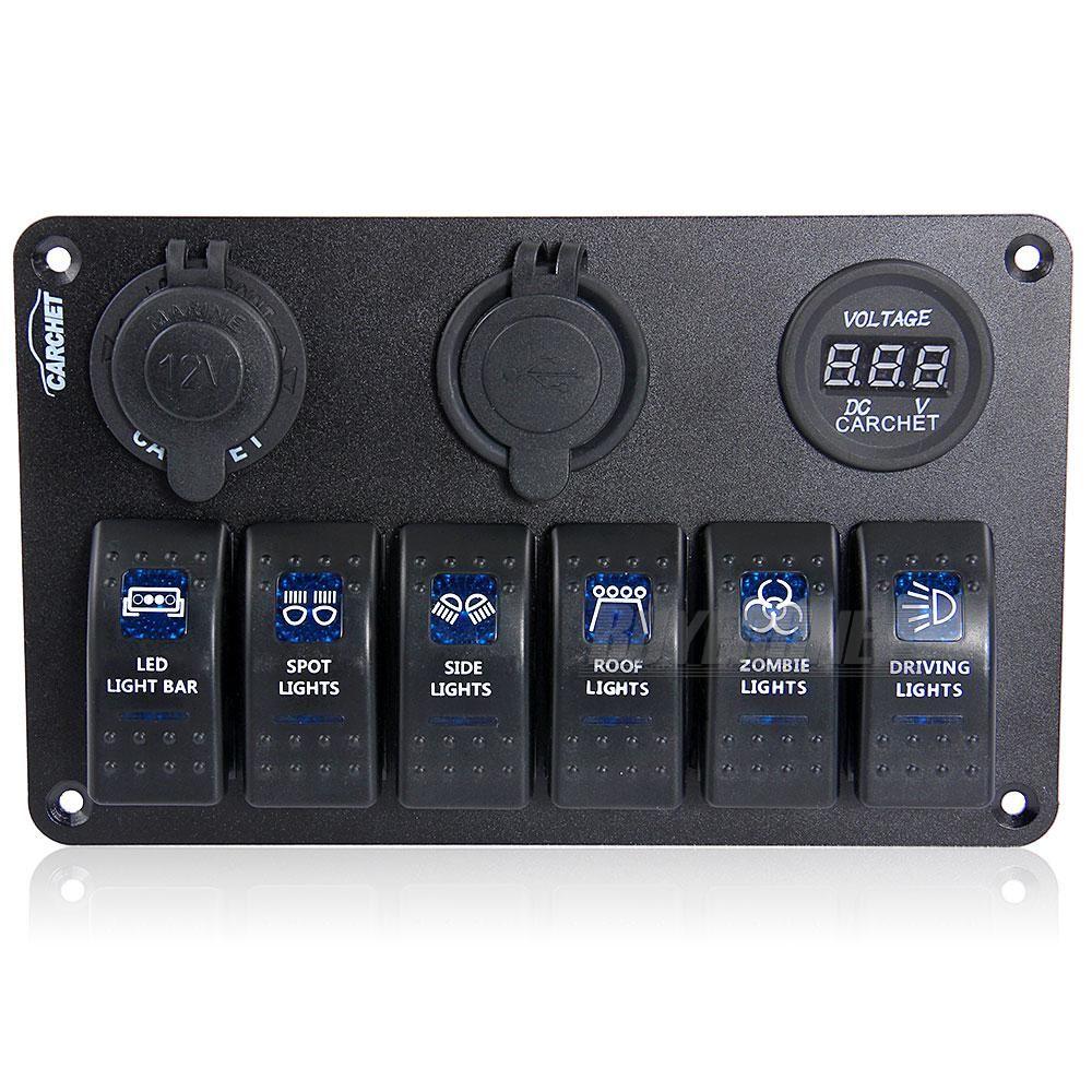

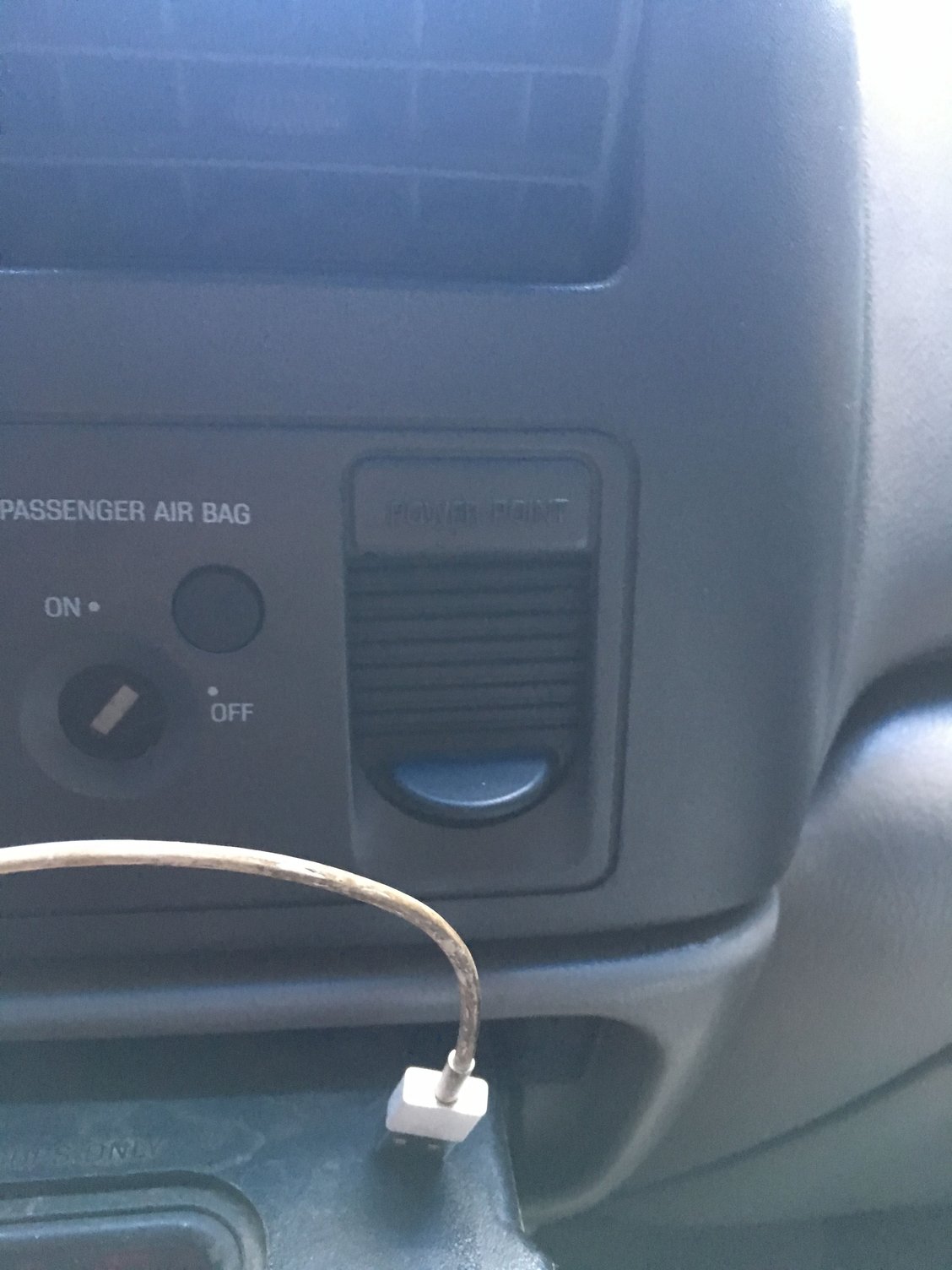

Pulled the dash apart awhile ago and swapped the old 12v port and replaced it with the usb. wired it to the ignition so it turns on an off
Sits flush so the little door still closes took about 10 mins to install
Moded this rocker panel picture at the bottom is what I modified. Fits snug but works switches have no resistance and work great. Wired these in with the headlights so they only come on with the switch.
This is the 4x4 switch cause the esof stopped working

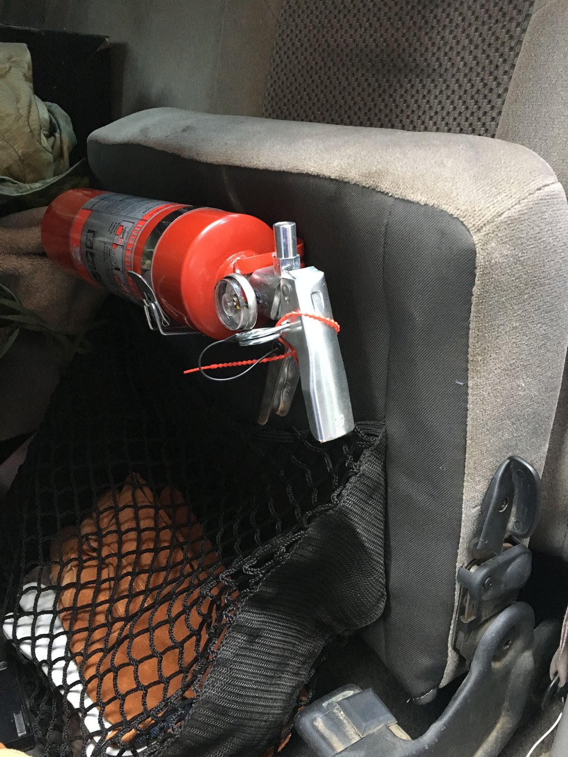

Took the seat off, took the fabric off, put a sheet of 3/8 particle board and put it all together then screwed the extinguisher to the bottom
This is what the usb rocker switches and volt meter looked like before I separated everything..
This used to be my esof but I drilled out the back of the switch. With this I can monitor my batteries when listening to the radio without the motor running and make sure my alternator is working. Wired this in with the ignition also so it doesnít stay on when Iím not driving
