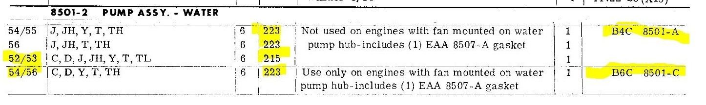

My recollection is that some Car water pumps don't work on Trucks, but I'm thinking that is the case with the 226 Flat-6's?
Anyway, here is which 215's and 223's share WPs:

Thanks guys. Also found a reman starter at O'reilly's for a '62 223. It looks like it will work in comparing the pics.

The difference between car and truck water pump installations is the type of fan you use. Trucks originally came with a water pump without a fan and have a separate fan mount cast into the thermostat housing. The separate fan uses a wide belt and the front sheeve in the two sheeve truck crank pulley. It sounds like your motor has the car crank pulley and water pump setup. This thread shows the difference between the two setups: https://www.ford-trucks.com/forums/1...ater-pump.html

Thanks Fred. On my 215 it looks like someone has put a car water pump on and mounted the fan to it. The upper water neck has the flat mount and two studs for the fan mount and I have the two sheave lower pulley/balancer but the upper fan mount was missing. Always wondered what the flat mount and studs were for. I'm going to use an electric fan anyway so that should free me up on water pump choices.
