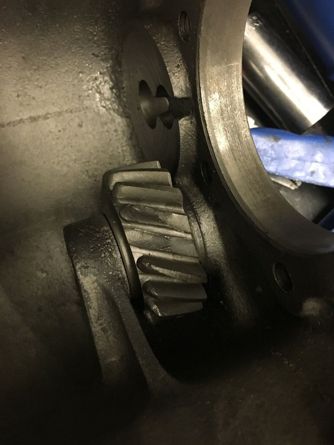

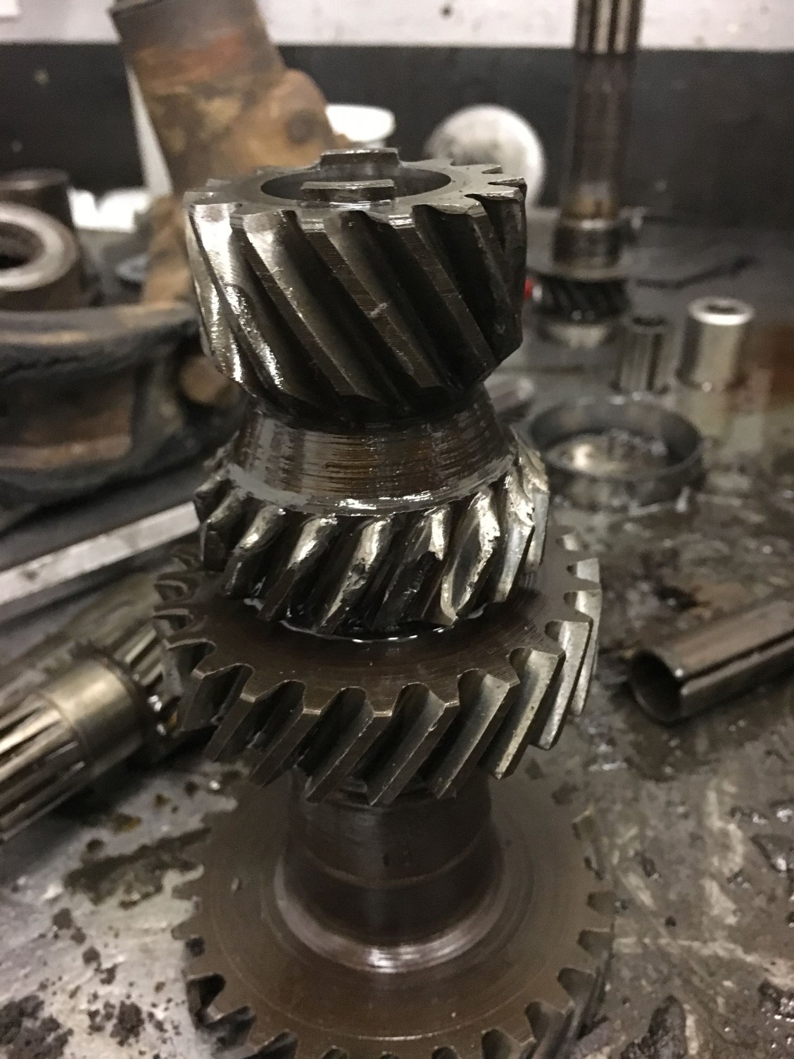

I have a 1948 F1 3sp light duty transmission (81A or 87A hard to read) that needs a cluster gear, 1st and reverse, and reverse idler gear. I have found a T87-D1 transmission. Are these two transmissions interchangeable? I know one is heavy duty and one is light duty but I believe they both have 28 teeth on one gear. Please help!

You can swap the trannies one-for-one, with some changes to the driveshaft, but parts don't swap between them.
Look closely at the rear mount on the T87. If it has the mounting ears up near the output, then it's easy to swap. If the mount has legs that extend down to near the bottom of the case, it will not be an easy swap at all. That is the model that was used in F-2's and F-3's with a different crossmember.
Was there water in the original LD 3-sp? I can't imagine all that being wrong with it. Is your trans guy perhaps being very very particular? Common for 1st/Rev to be chipped up, others not so much.

Cluster gear was really worn and broken, reverse and 1st had numerous teeth broken.

Looks like either someone was impatient or the clutch was dragging. eBay is good so long as you know exactly what to look for. There are still plenty of complete trannies in running condition being yanked for modern drivetrains, watch around.

Dennis Carpenter has the cluster gear NOS; or at least he did 6 weeks ago when I bought mine from him.
You need to make sure of the gear counts when you order.
The rest of the parts were relatively inexpensive on ebay and through Van Pelt. In fact, I sent Mac VP a list of all of the parts I needed after I found the cluster gear, reverse, and first gears. Took him a few days to translate my list into available kits (to save me money-his suggestion!), but once I got the parts I was very pleased.
I haven't totaled the parts cost for everything, but I'd guess it was less than $500.00. A little labor on my part and I have a practically brand new 3 speed light duty transmission.
