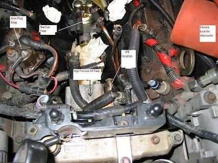

Sounds to me like the tin nut has come off the back of the IPR and the solenoid is sliding back every time you take off.
If you remove your chip, MAKE SURE you disconnect the NEG battery terminals (both) before you do.
I'm new to these trucks so what's the ipr?

Injector pressure regulator, controls high pressure oil to the injectors.
