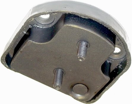

1985 F-250 4WD with a 460.
The lower side of my oil filter is so close to the cross member that I can't slide a pine needle between the filter and cross member.
This seem so close too me, worn motor mounts?
What's the normal amount of clearance?
I think this is the mount I need
No, all original.
I'll look in to that, though I have no idea what it should look like originally.

I don't have experience with different motor mount brands, but I am an engineer specifically dealing with motor mounts for passenger cars.
The only difference I can imagine you would see from different brands is the quality of the finish, and accuracy of the mount assembly itself. It could be, perhaps, that one manufacturer does a bad job of metal preparation and adhesive coating prior to rubber injection - but that would only be evident by rubber/metal separation after time.
From what I understand, most of the time these "legacy" tools are transferred from the original production supplier to some "service" company who is willing to make aftermarket batches of parts. I could imagine that all these different "brands" purchase the motor mounts from the exact same supplier and put a different price tag on them - because none of these companies want to "tool up" their own aftermarket motor mount to sell to us ford-truck lovers - but that's just a guess.
And, yes, rubber will sag over time when under load. Typically all sag will have occurred within the first 5 years of use, and no additional sag will occur after this - only additional wear, cracking, deterioration.
Not that any of this matters to you! But I hope I could help!!
-Adam
-Adam
Thanks, your theory about brand differences pretty much mesh with mine. I think this is something I don't need to over think.
