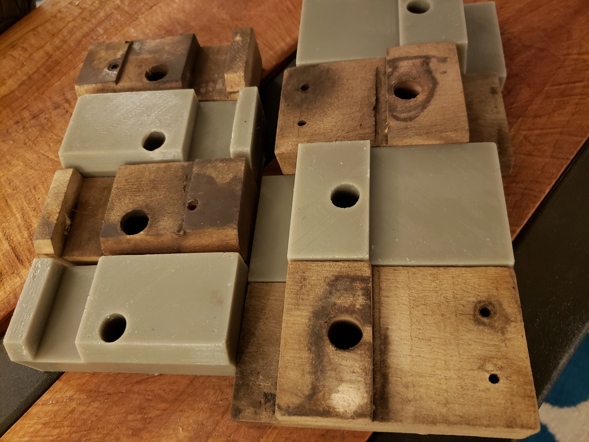

Cab mounts
I was wondering if anyone had the pdf or iso files to make cab mounts. I would like to build cad files and post some info on casting them out of poly for future rebuilders. I can post the .stl files for guys who 3d print their own molds so they can share, I just need some accurate dimensions to start. The threads I have seen are giving accuratish numbers but not the tolerance I'm looking for. It would be nice to mount the cab on some semi rigid bushings and not have to ever worry about them again.

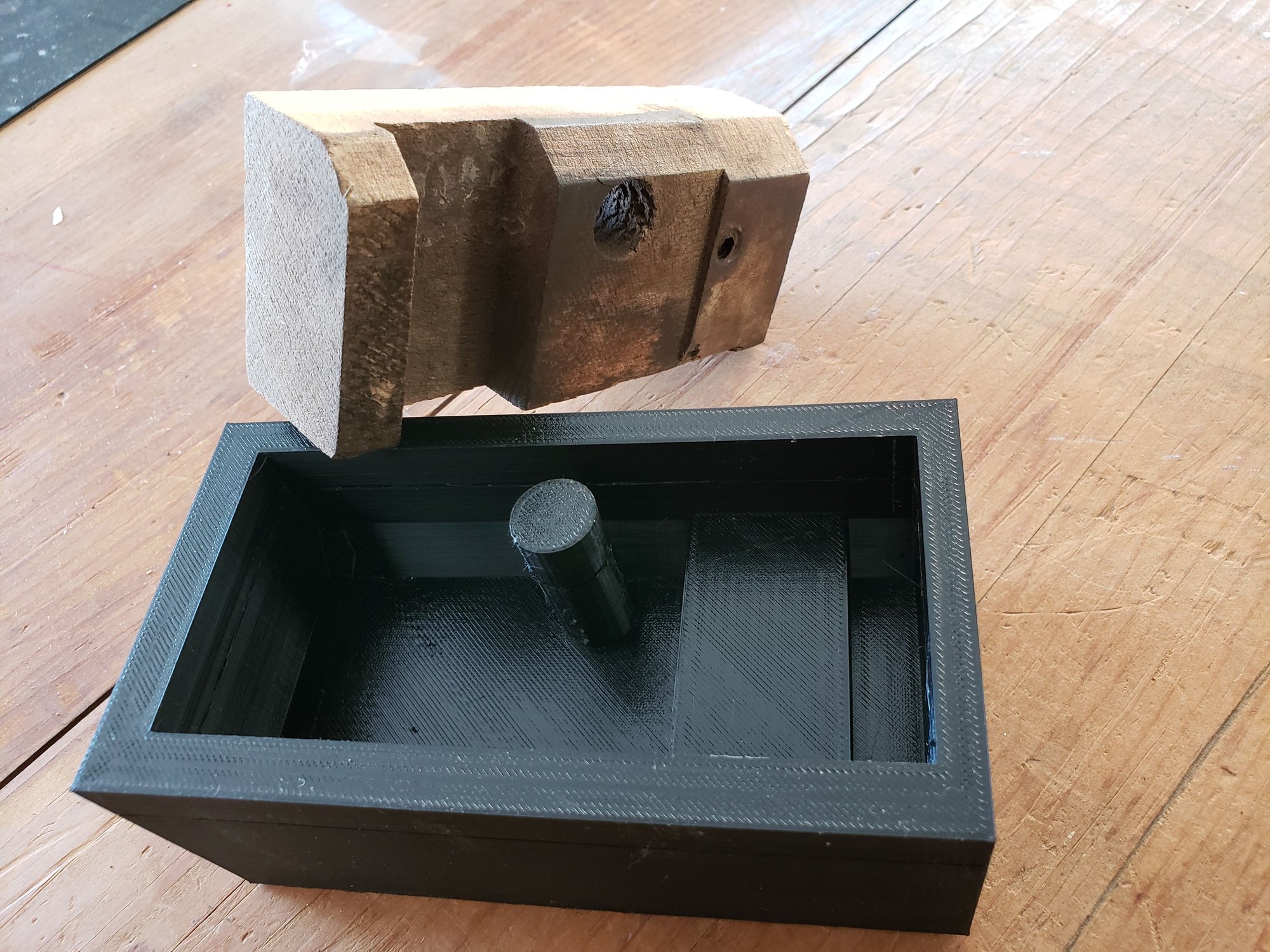

Urethane cab mounts
3d printed mold based off of original wood cab mount. I think I will make a second generation that is a little thicker and cast in a slightly forgiving material so that it cushions the cab a bit. This will negate the requirement for the rubber shim between the wood and cab. Should reduce cab noise as well.
Hard urethane cab mounts to replace the nearly 80 year old wood ones. I will post the cad object files so somebody can cast their own in the future once i figure out how to add it to the posting.

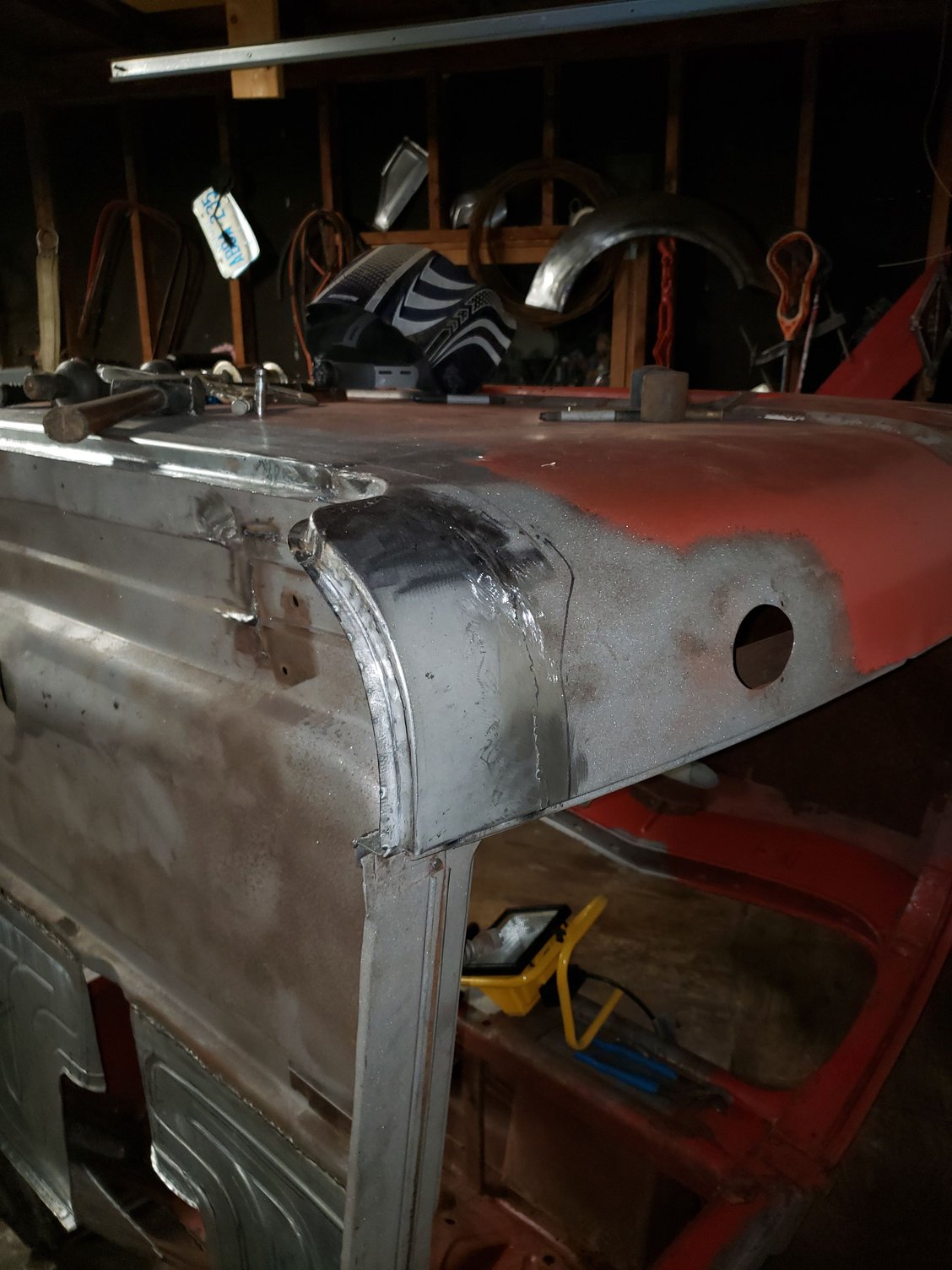

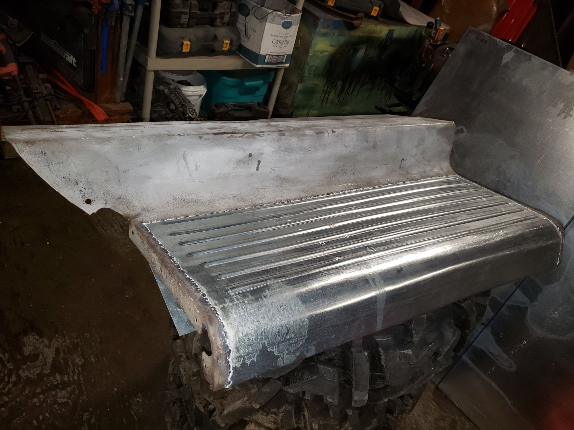

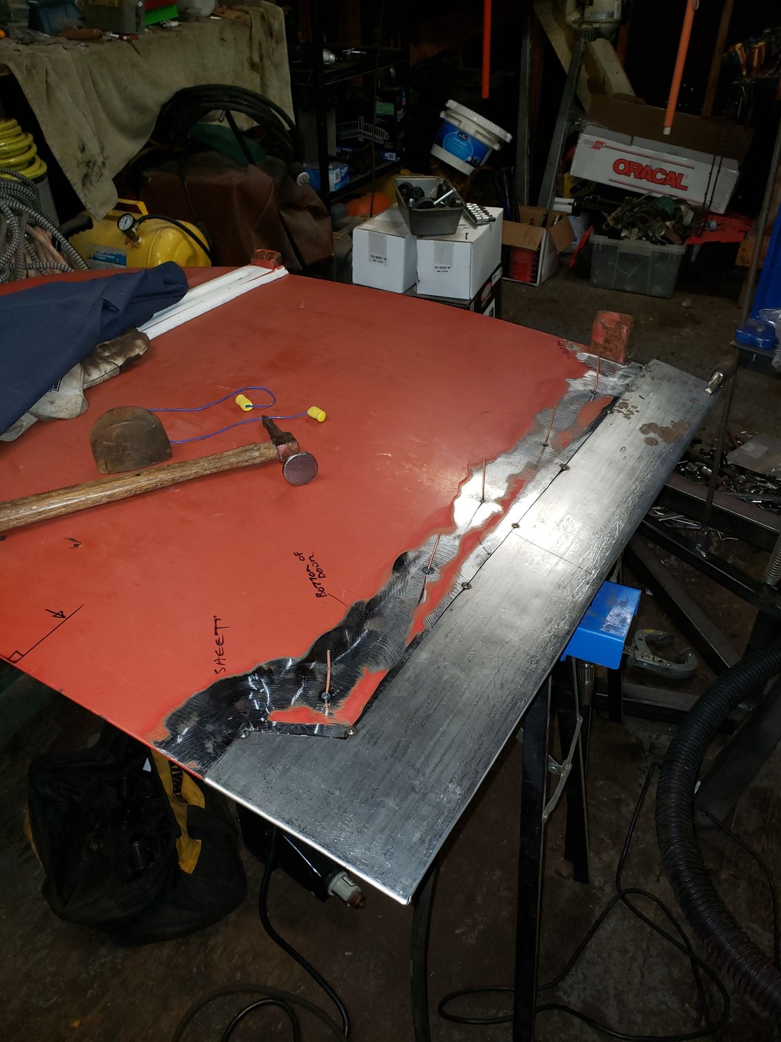

Slowly replacing the rot....
Found it easier to replace a whole centre section of a step rather than do a bunch of small patches.
Replacing both door lowers inside and out

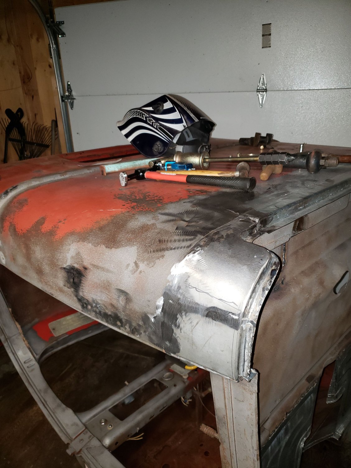

Bought cab corners from reputable company to save time...... had to completely rework them to make them work as they did not fit in any dimension. Very disappointed for the price.
Both side cab corners were not even close.
