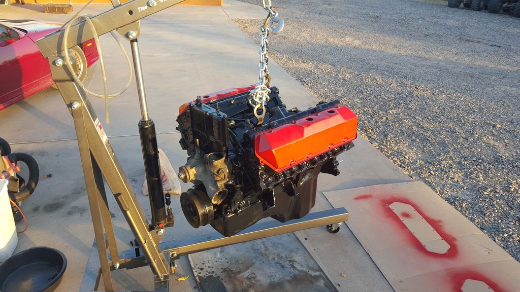

Again this is what the engine looked like when coming out:
You can't really see how dirty it really was, but it was a gobbed in so much junk.
And here it is after I painted it:
It looks a little nicer with the stainless steel valve cover bolts I bought. I'll see how it looks when I get the HPOP, fuel bowl etc all back on. I want to paint the turbo pedestal and housing as well. I'm not sure if the turbo exhaust housing will hold up well to the 500 degree paint, but I suppose it won't hurt painting it now while it's off. I don't know if I want to paint my new water pump that's coming in either or leave it the metal look.

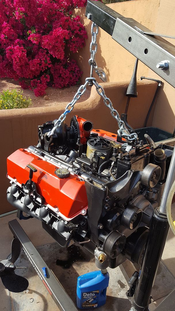

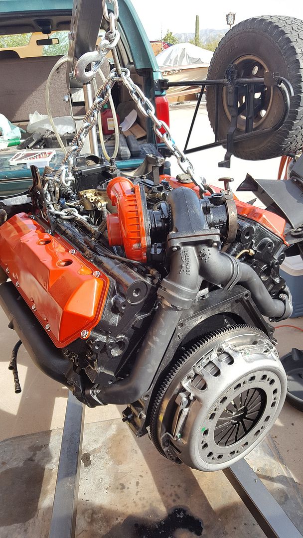

I got a bit more work done finally. The engine has been collecting dust sitting outside next to our pine tree.... I kinda wipe it off now and then but it's going to get dusty eventually when it's installed....
Anyways, here are the update pictures:
I got the water pump with the coolant filter isntalled, the new HPOP, both accessory brackets, the ceramic coated exhasut up to the turbo installed, the fuel bowl/lines resealed and installed and the fuel pump installed.

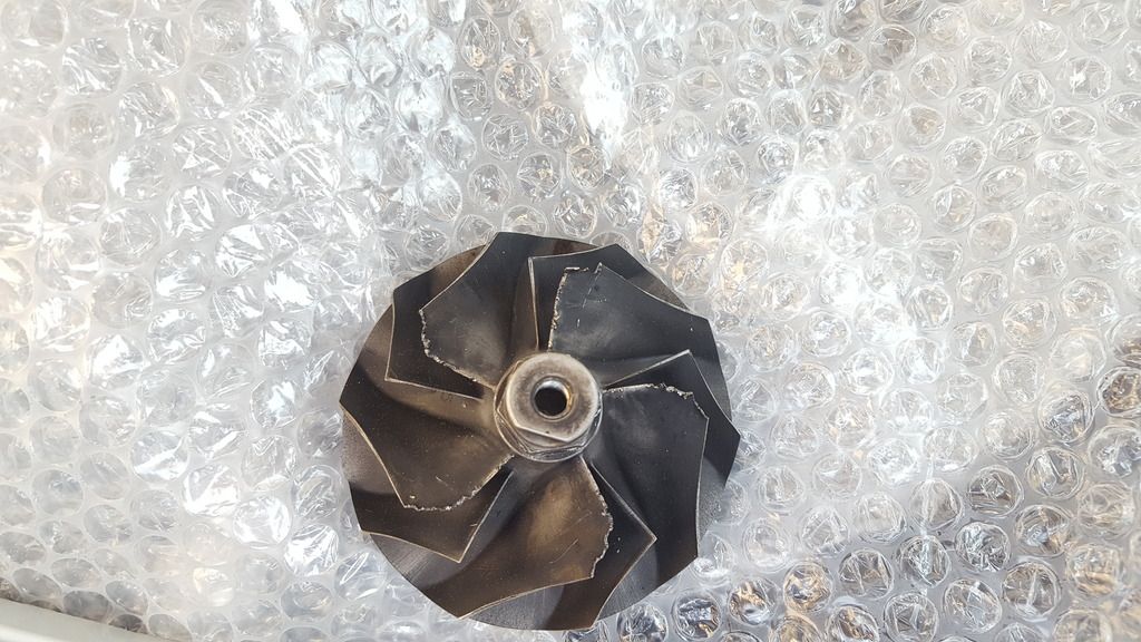

I also painted the turbo and installed a new wheel. I don't image the hot part of the turbo paint will hold up for very long, but I figured why not paint it while it's out.
Here is what my old wheel looked like:
I really hope that the internals of the engine are okay... I've seen worse dusted turbos online, but this doesn't look too great..... The new turbo wheel looks great though!

That turbo wheel does look a bit frazzled, but I've seen worse for sure. The main thing that is important, is not having any play in the shaft, that means a turbo is about done....
