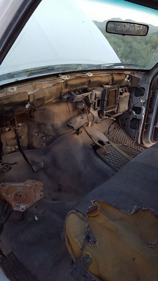

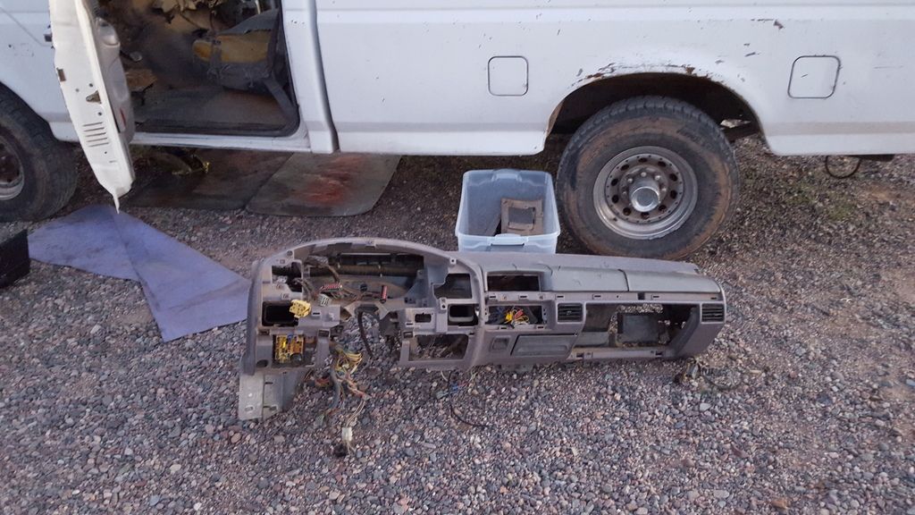

Anyways, here is the progress I made today:
I was surprised at how simple it was to remove that dash! At first, I was taking off the dash skin. I soon realized that was a mistake and found a walk-through on how to remove the whole dash! That was much easier!
I got the cluster, bezel, and gas pedal all in my room now, and set the dash aside on my driveway. I just need to get the engine wiring harness, the exhaust, and drop the fuel tank(s) to get the needed parts for the fuel system. Once the motor is pulled, I imagine it will be pretty easy to get the wiring harness out of the engine bay!
Anybody need any interior dash parts haha? I know I won't be needing this steering column, HVAC controls, glove box etc. so I have to figure out what to do with them. Selling them would be nice, but I don't think there is a good market for them so I'd rather give them away to someone here who may need them then have to toss them! I won't be tossing any parts until my Bronco is running with the Diesel though so I'll have them for a while if anyone needs them.

Wow!!! Looking at that fuse panel is really making me shake my head at how unbelievably simple it is, compared to the IPs on today's vehicles. You should see how much wiring and modules are involved on a 2011 and up 6.7L diesel F-250. If I'm not mistaken, your Bronco being based on a F-150 chassis also uses a Driver's air bag whereas the F-250 and up trucks of that era do not. Just to point out one detail I remember. But yes, you will most definitely need the dash harness and cluster to go along with this swap. The 7.3L redlines at 3200 RPMs if I recall correctly, and also has the tach to reflect as such.

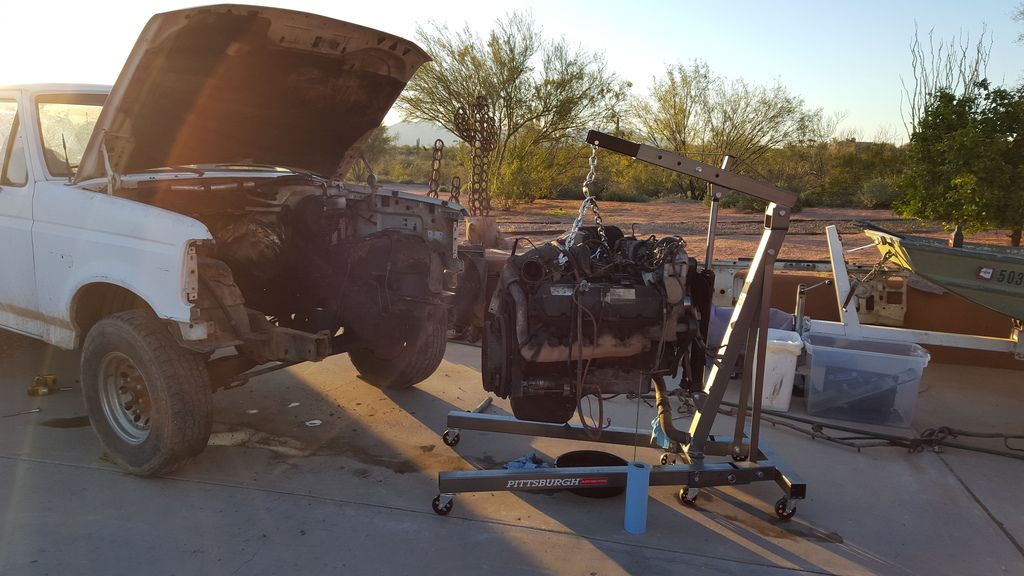

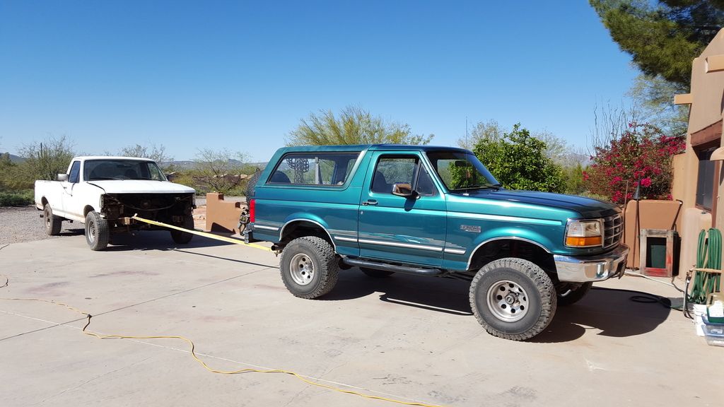

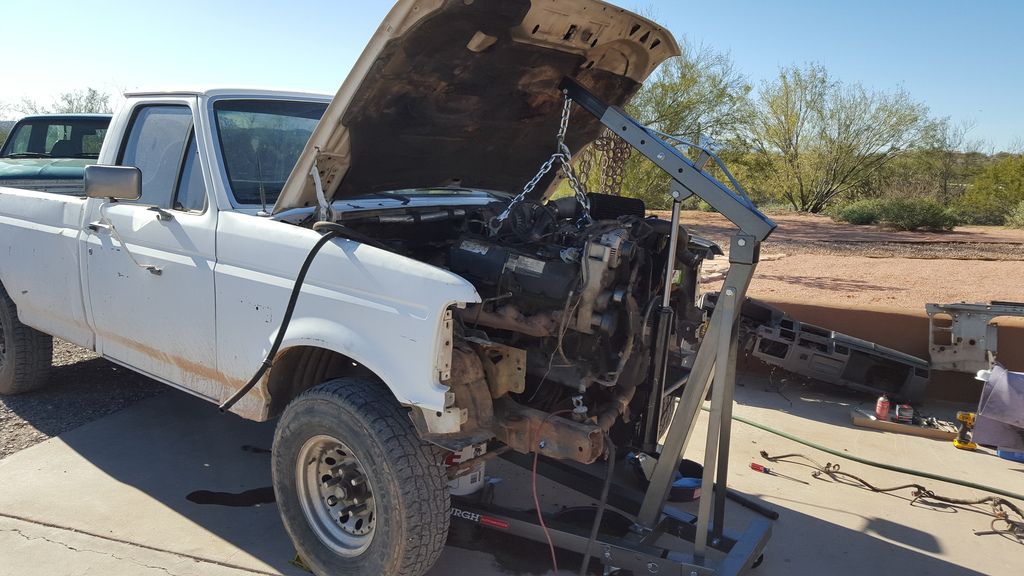

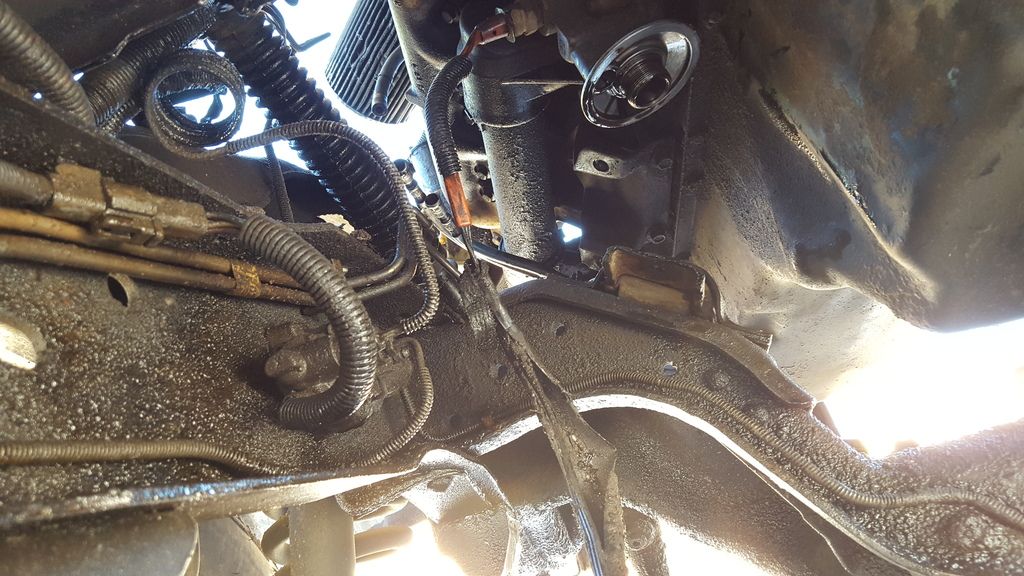

Anyways here is the progress I made today:
That's my professional towing job. I moved it like 100 feet and had to place the steering column loosely around the shaft to turn the F250 wheels. I had to get in and out a whole bunch to make adjustments because I had no helpers today. It got far enough to get onto pavement though which is all I needed!
I almost forgot to undo the fuel lines when pulling the engine forward. I had the bright idea of leaving the starter in too when I pulled the engine. It barely cleared with the starter in place. I'll definitely make sure that I pull it before installing the engine. I was wondering why it wasn't wanting to move any further forward when I was pulling! You can see here this area is pretty grimy with oil/junk too. The front end area where the two fuel rails meet was the dirtiest of all. I don't know what could be leaking oil around that area except from the power steering pump. Hopefully it was just that making a mess. I'll have to figure out how to prevent it from leaking when I install the engine.
This is where it was getting stuck from the starter/fuel rails. Once those were out of the way, it was "pretty easy" to roll it forward:
I'm amazed at how much oil these things hold too.. it seems like 4 gallons came out because the white 5 gallon bucket I used is pretty full. I read these only hold 3 gallons but maybe it's more?
Last but not least!!
Just in time for sunset too! I was thinking I'd get everything pulled and could move the truck back off the concrete today but I left it at that. I have the whole exhaust unbolted, but I couldn't get it around the rear axle so I'll have to cut it up. It has to be cut anyways to meet the length of my Bronco, I just wanted to avoid cutting it in the meantime because it's a hassle to do, but I'll have to cut it out sometime this weekend. After I get the exhaust out, I'll just have to take out what I need from the fuel tank(s) and I should have everything I need from the parts truck! I'll have to look up exactly what I need from the fuel tanks on the car as well. I think there is an external pump I'll have to take, but I'll have to look up what else is needed!
