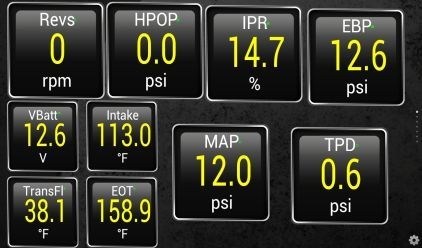

Here is a screenshot of my KOEO -
Notice the half pound difference? I'm not sure what that is, but no big deal really. Also the trans fluid temp (Manual Trans) seems to be displaying C rather than F.

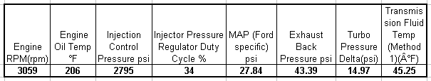

Made an unloaded run today with some hard accel onramp. No load or grades, here are the MAX from the log...

Torque Pro has a setting for metric or imperial - you can fix the degrees C problem in the app settings.
15 PSI is a little high for what looks to be a stock tune at WOT. Was it cold when you started? A cold engine (below a certain temperature) will activate the EBPV in idle, and that gives 15 PSI - that could be when your max occurred.
.5 PSI differential at KOEO could be nothing to worry about, but this is one of the very few times when EBP, MAP, and BARO on the screen can tell you how the sensors behave at rest. If you consistently get a 15 PSI TDP on a stock tune, this calls for logging the data and having a good look as to why - that's a little too much.

Engine was warm both for KOEO and the test run. From the log the TPD 15psi occurred during hard accel from 35mph to 75mph with gear shifting (manual trans).
TPD at idle on the same log ranges 0.9 to 1.12 or barely above KOEO.
But yes, when boost kicks in I can feel it in the seat of my pants!

Maybe we're just seeng a spool-up delay. Max PSI for the EBP sensor is about 53 PSI absolute - 10 PSI above your MAP max reading. The MAP sensor "clips" at about 48-50 PSI - sensor max.
