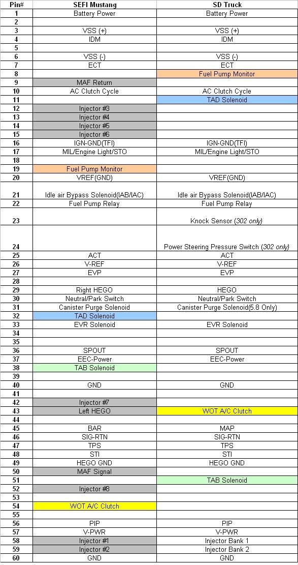

Ok so I have most of the parts needed now. An a9l, MAF, and injector harness out of an 88 mustang. I also have the moates quarterhorse tuner and I downloaded tunerpro rt. I guess i still need the harness for the MAF, but im not sure if im looking for another harness or just a connector that i have to splice in. If it is something i splice in how do I do that? Since the connector for the plug is not on the injector harness is it still nessisary to swap the injector harness?
Since the a9l is for a 5.0 ho i need to switch the pins for injectors 3 and 5 and 7 and 4 on the harness side, is that correct?

You have a bunch of pins to move and add so here is a list to use as a reference. The mustang harness you have is laid out for a passenger side PCM location which is opposite what a truck has, so you'll be dismantling that to remove the injector portion and then when you source a MAF sub harness add both of those to your existing truck harness. Wires at pin locations in color have to be moved, wires at pin locations in grey are to be added.
