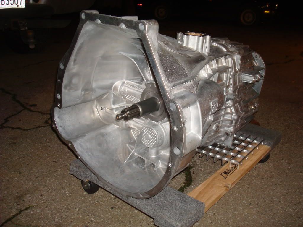

What's your budget? I bought a brand spankin' new ZF6 a few years ago from Joe's Transmissions in Pit, PA. It was out of Canada.
I bought a new trans from them lasy year as well. Worked great other than a messed up clutch.
I have had a ZF5-S42 a ZF5-S47 and three ZF6 transmissions and pulled with all of them. The one thing that I do not like about the 6 is 2-3 step is a 0.79 ratio change and loaded heavy it is rung out in 2, and upshifting to 3rd there is a big drop in rpms. It needs a gear between 2 and 3 at least pulling 7-8% grades here stock and 3.73 rear.

Anyone have more information on the new ZF6?
They are new old stock from a warehouse/dealer. They supposedly keep them currently in a warehouse out of the elements.
The name of the place was Joe's Transmissions in or near Pittsburgh, PA.
Here's my ordeal. I went big and made my own cooling system for it, which I'm happy with.
https://www.ford-trucks.com/forums/1...ot-good-4.html
