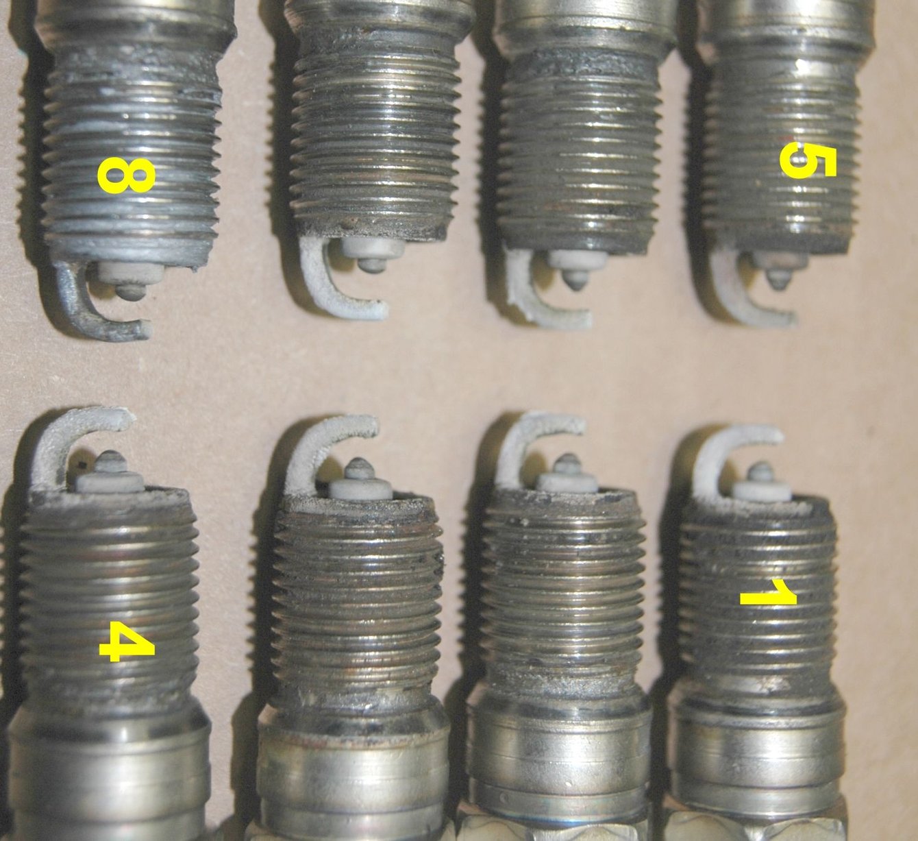

Im still waiting to see a 250k mile spark plug.... Heck show me a 150k mile plug....
Read & view this thread: High Mileage Plugs
Might be more mileage than you asked about but interesting none the less.
Also here are some SP-479's from my '03 E250 with 5.4 V8, about 226 K miles when removed:

That picture makes me feel better about not changing mine yet. Thanks!

Eddienelson and super 6.8
i changed my originals at nearly 300,000 and documented it here on FTE. Confirmed originals.
The gaps were over 1/8.
I did it because of some minor but persisten misfiring. It ran a little bit smoother with new plugs but still had the misfire. Turns out the misfire was due to a tiny hole in the head combustion chamber.
Everything is documented with pics here on FTE.
Delgriffith wins the award for highest spark plug wear on FTE, but I still hold a firm 2nd place.
I removed mine carefully with a 1/4 Dewalt impact after spraying some WD40 in each spark plug well beforehand. And I (literally) prayed, and then used light throttle on the Dewalt.
Easy peasy.
