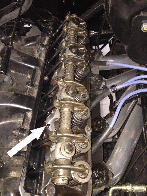

I was installing some new valve covers on my rebuilt 390 FE and I believe the builder messed up. I believe the oil diverter (not sure if that is the right name) rail is facing the wrong direction on the drivers side of the engine. The passenger side is reversed.

You're right, they go on the spring side.
Oil diverter tins.
The way they are oriented there, they don't divert anything.

6524 = Valve Spring Oil Baffle
