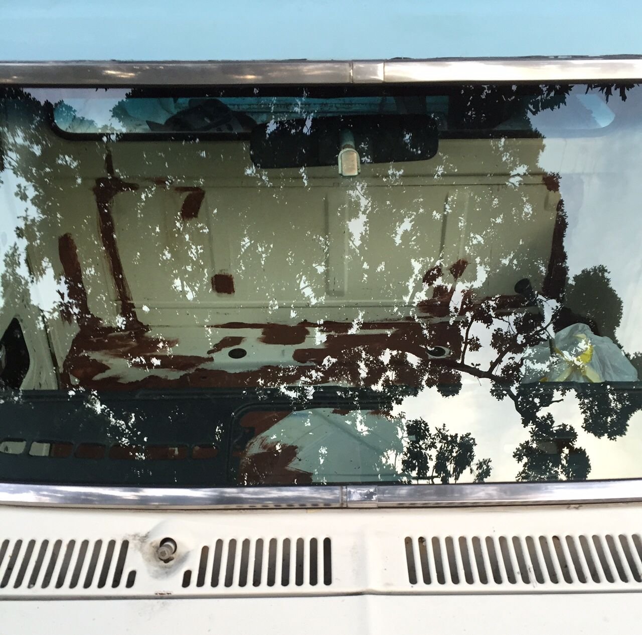

I got a new windshield today, the guy who put it in got one with a mirror bracket so he glued one on. It is off center of the windshield. He is going to fix it but the old glass is gone so I cant measure it.
Can someone measure if their mirror is in the center of windshield measure side to side? And then, how far down from the top is it suppose to be?

The mount button is 2 5/8" down, measured from the w/s rubber seal the top of the mount tab.
And letting the tape measure follow the curve of the w/s, it is 31" on the dvrs side. That is from the w/s rubber seal to the l/h side of the tab and 31.5 on the passenger side.
