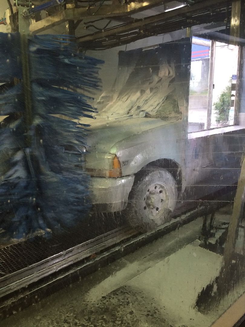

also with the E99 you will generally find the following emblem on the front fenders as pictured below while my truck was in for its bath....sorry its the best shot I could find showing the emblem at the moment, I can if wanted reupload a new image tomorrow...
