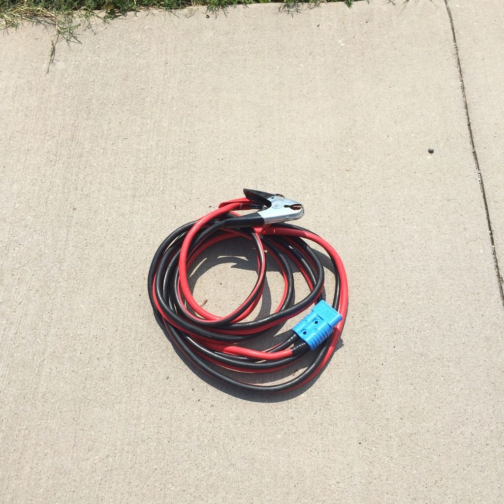

Anyways on the build thread front I found and received the jumper cables for my truck so now I can jump cars with out the need to mess about under the hood! However the cables on the truck plug look to be 4GA and the cables that are on the jumper side are 2GA so I hope that won't cause an issue (the total amps is well under the 600A rating for the plug)

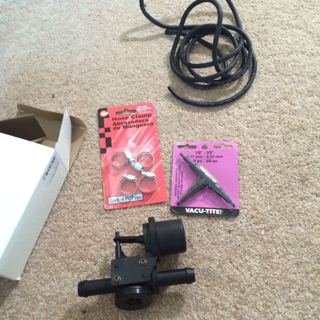

Well as an early bday gift for my self I got the items for the A/C mod to shut off the hotwater to the heater core!
Heater valve is AutoZone part number 5968 (74859) Everco by four seasons pics are below!!
here are the jumper cables

ok, here is an update to the build, I got a 4 port heater valve installed instead of the single, I know it may not make much difference but meh I wanted the water flow to return...
next will be to plan the routing of the vac line which is going to be a PITA I bet but at least the worst (i hope) is done....

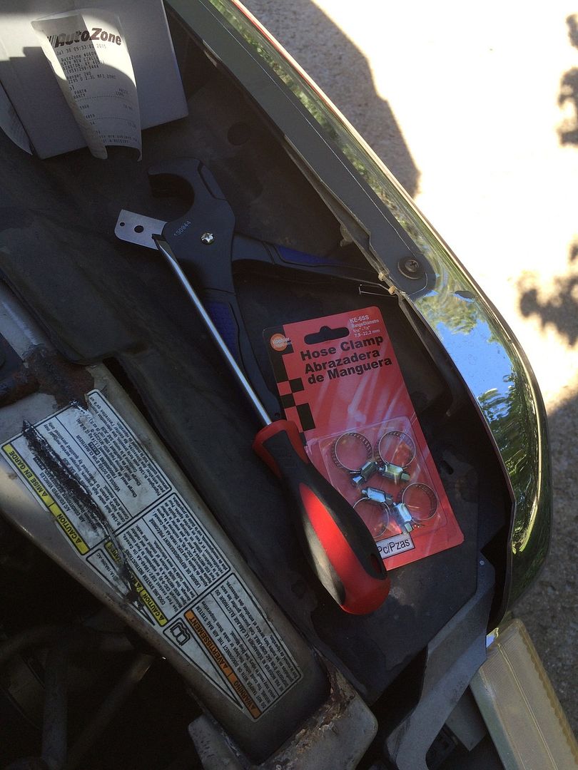

anyways here are the pics, first is the tools I used, NOTE: the RED package of clamps (as prescribed by the original mod author/post DID NOT work for my truck, if you have a E99 you may need the GREEN package (the next step up) of hose clamps to work properly!!

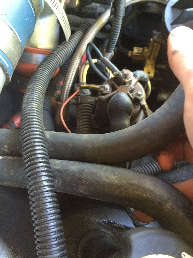

the hoses before cutting
the valve (labled with what goes where)
The valve installed, sorry, didn't take any pictures hooking things up as it should be pretty self evident as to where things will go, however I am a bit concerned that I may have put the valve too far forward, and should maybe have placed it closer to the heater core for more room for the vac piece on the valve...(thoughts??)
