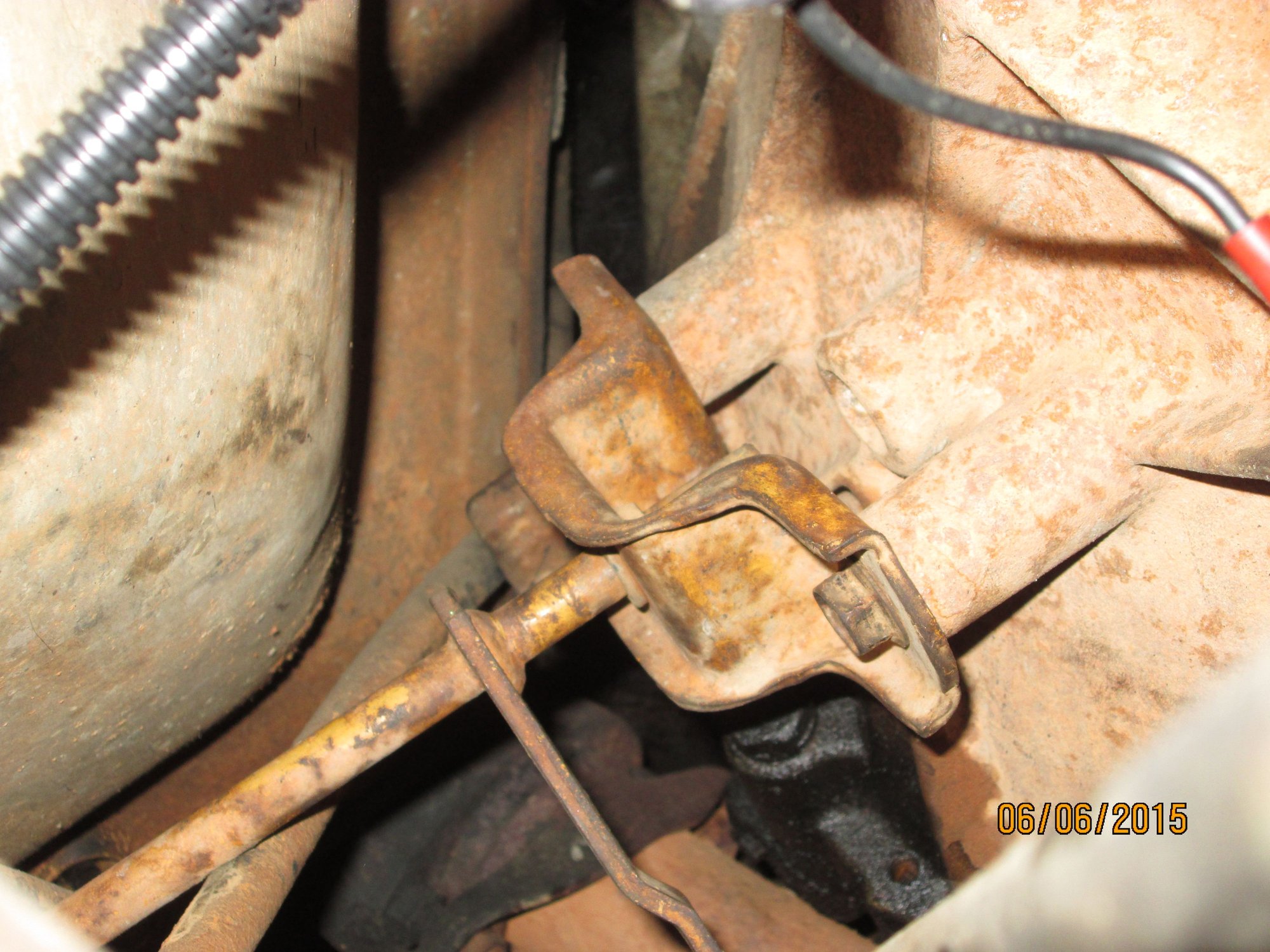

This is on a 1989 F250 7.3 IDI with an E4OD. It has a rod-style bellcrank shifter linkage, not the cable like later trucks. there is a bracket that bolts to the bellhousing, and it has a rod that runs through it to a bracket on the frame. I'm looking for the part number for the plastic bushing that fits in the bracket on the bellhousing. Its painted yellow for some reason. Any help is appreciated.

The part number for that bushing is as follows: E0SZ-7341-B. That bushing was used on the C6, AOD and E4OD as well as some others...

Thank you so much.
