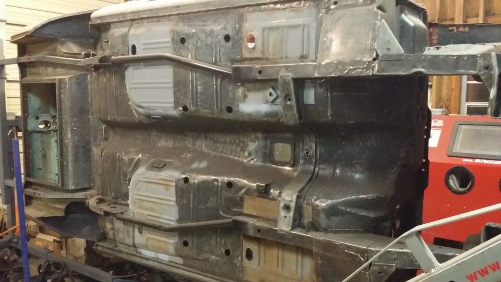

I put floor pans in my '68 Mustang years ago. I cut out all the bad, rusted areas so that the rust wouldn't continue to migrate into the good parts of the floor.
I laid the new pans over the holes and from under the vehicle traced an outline of the holes onto the new floor pans. After that, I took the floor pans out and then cut them an additional 1/2" outside the lines, drilled 5/16" holes around the edges about every 1-1/2" and then plug welded them in.
It's a lot more work but, if I had to do it over again, I would butt weld (flush fit) the new pans to the existing pan. Once the new pans are butt welded, the welds ground smooth and painted over, you can't tell they've ever been replaced and it looks factory original.
However, having pans lap welded/riveted over the existing pan is a lot better than having gaping, rusted out holes in the floor.
This is the belly of my '68 Mustang.
